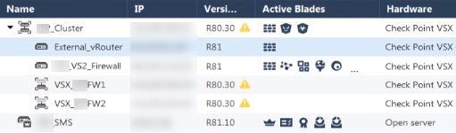

After failed vsx_util upgrade operation, status of GW/VS objects in Smart Dashboard was as in following picture:
It is strange that virtual route object was on new R81 version, even though virtual router was complying - policy compilation failed error log. This does not match with error log messages. Only VSX (VS0) context was on old R80.30 version.
I checked policy installation target colomn in Smart dash and it seems like Okay:
This part from logs - messages from VSX_FW1_External_vRouter and VSX_FW1_External_vRouter is not understandable. We do not have these object names defined in smart dash, for non of the GW's/objects under Gateways and Servers tab.

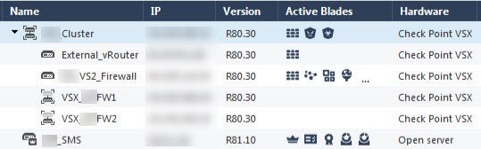

MGMT server is reverted from snapshot to state as was before vsx_util operation problems, and is working with defined objects as follows:
All policies are installed and all setup is AS-Before.

i had same problem upgrading VSX from R80.30 to R81.
vsx_util upgrade on mgmt finished correctly, but not all the virtual devices changed version...few remained R80.30 and i could not install policy on them.
Solution is changing version through guidbedit, doing a connection between mgmt and vsx changing something (ex. i enabled a blade and then disabled it), reinstalling policy, and it worked fine.
