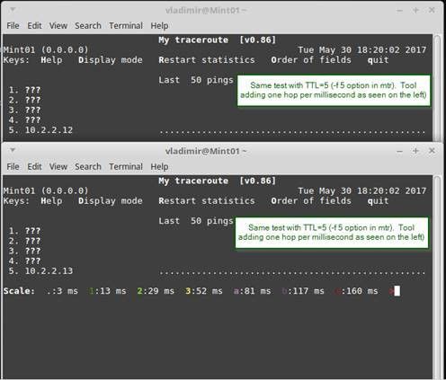

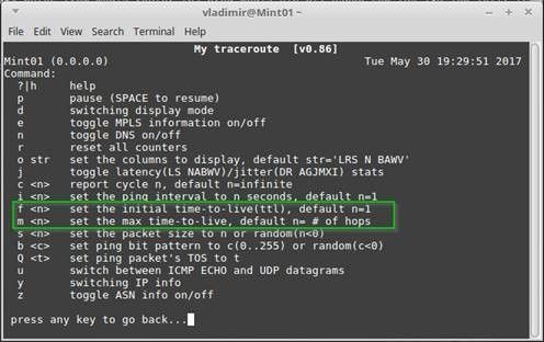

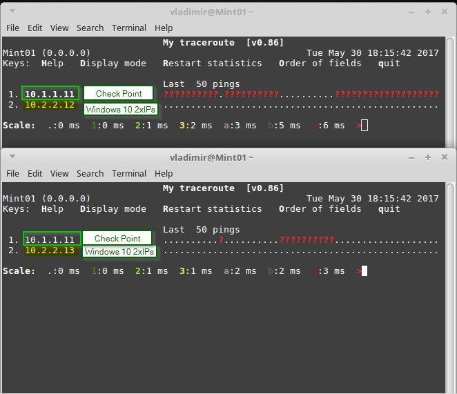

Without recounting most of waht was written about above, here is the one from few years ago:

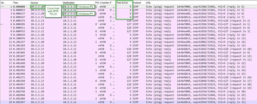

Client states that traffic going through check Point cluster to one of the multihomed AS/400s was being arbitrarely dropped.
As a proof, they have shared the graphs from the Linux MTR (my traceroute) tool.
On a surface of things, it did look like CP was the culprit.
Ended-up being completely unrelated issue, but to prove that it was not a firewall, I had to create a moc environment and have discovered that they were using MTR default TTL 1 per hop, which was decrementing by 1 on each hop. Check Point's processing traffic on iIoO was decrementing the TTL to 0 resulting in a false positives for the tool only, but not for the actual traffic.

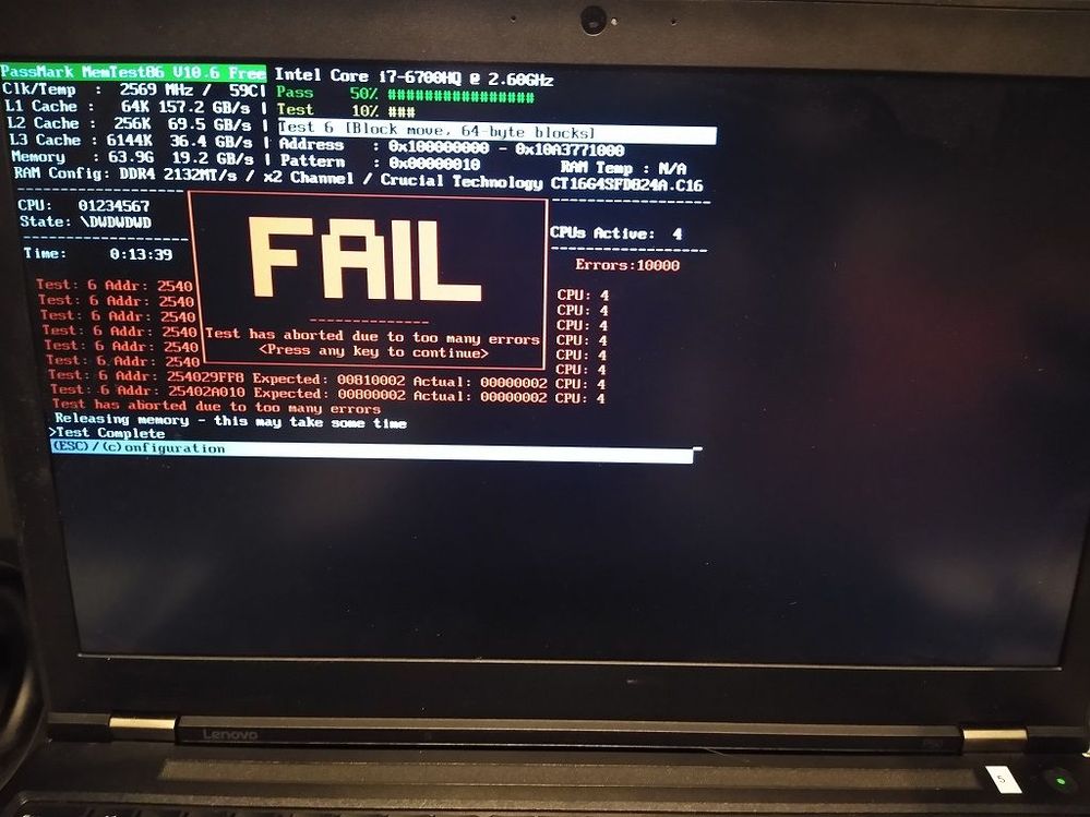

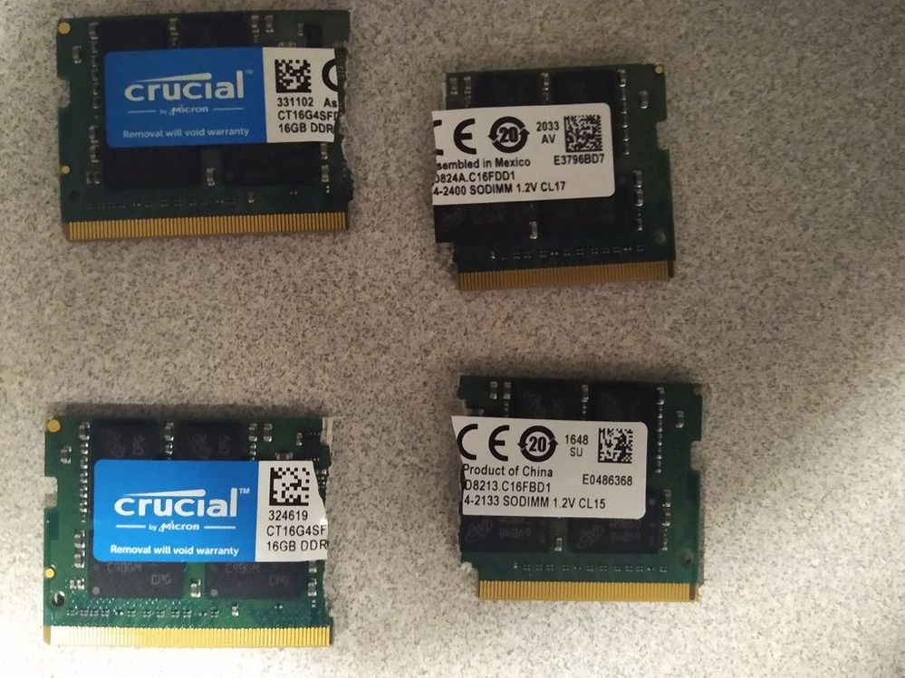

Last week I was running a CCSA class and things went pretty badly wrong on one of the lab workstations an attendee was using. Just a "-" status showing up in SmartConsole for everything, random policy installation failures, cpd crashing constantly etc. Also was seeing "BUG: soft lockup for 22s" on several of the Gaia systems. All other attendees on their lab workstations were fine, and all the lab workstations are cut from the same base image so I was starting to wonder what the heck this attendee had done.
Dug into the bad workstation after the class was over and it seemed the configuration was simply flat-out corrupt on all the Check Point R81.20 GA virtual machines, along with soft lockups occurring randomly. Started to suspect a possible workstation hardware issue so I downloaded all the latest diagnostics from Lenovo and ran every possible extended diagnostic including a full media test of all hard drives/SSDs. After a few hours all tests pass with flying colors. Hmm...
At this point I'm desperate and boot up a USB copy of PassMark Memtest86 which I would normally only do when upgrading or changing memory sticks. This is a great program that hammers the heck out of RAM for about 12 hours trying to force bit errors in borderline memory sticks. The memory sticks in this workstation had been tested several years ago when I first installed them and passed 100%.
So I fired it up and not 15 minutes into running the test this appears:
What the...??? Never had a memory stick partially fail like that after working fine for several years. So after swapping out the two pairs of dual memory sticks, moving them around between different slots and retesting, I conclusively identify the pair that is bad. It is most likely only one of two sticks in the pair that is bad, but I've spent so much time screwing around with this, here was my final solution accompanied by some extremely foul language:
Man that felt good. Rest assured that the fragments will be e-recycled properly. My fear that was the e-recycler would just end up putting them up on ebay and some other unfortunate soul would end up with them. Not gonna happen now...

I've run into issues with solder "whiskers" and "bad" solder joints that appeared to fail based on temperature. With all the solder contacts on a single memory stick -- let alone a motherboard -- it's truly an incredible thing we don't deal with this type of thing more frequently. The fab process for chip manufacturers must be a fascinating thing.

Interesting one chip from China the other from Mexico.
I notice also that they are mismatched pairs. One is 2133 speed while the other is 2400.
That can be a recipe for disaster. I would have tried one stick at a time and also confirm which speed
the board is supposed to have. It's possible neither stick was actually bad. Having said that I find laptop
memory to be the least reliable.
Excellent catch @Tony_Graham . agreed. that's a mismatch and recipe for disaster.
However, I would ask why the mobo would not simply run both at the slowest speed (ie. you would think the 2400 module could run at the 2133 speed)?

With anything remotely modern (and anything which can run DDR4 is definitely modern enough), speed mismatches aren't a problem. The controller will just train both channels at the lower speed.
I don't think I knew Micron did any assembly in Mexico. I wonder where the chips came from. They don't have any fabs anywhere near Mexico last I checked. Fab 6 in Virginia is probably the closest, but they do their own assembly. They have a bunch of fabs in Taiwan, but again, they do assembly locally.
Probably somewhat depends on the quality of components used. I recently had an HP laptop exhibit the same issues. I tested each module individually since the laptop would not even boot into Windows without bluescreen. It ran fine on one stick but with the other it would not boot. I also tested on different DIMM slots just to be sure the slot itself was not at fault.
Agreed Bob, speed mismatches really shouldn't matter given that combo of memory worked just fine for about 4 years or more. The motherboard they were plugged into could only go 2133, so I suspect the 2133 module was older and based on my records probably purchased in 2017. The 2400 module appears to have been purchased in 2020 or so, which is a frequent occurrence as the older 2133-only modules became scarce and expensive when faster modules became available. My guess is that the older China 2133 module which ran at maximum speed its whole life is the one that failed; didn't notice the country of assembly difference but if I had, I probably would have had a grudge match between the two modules I snapped to see which one (and country) was actually the bad one. Didn't really care at that point, guilt by association in my book...
