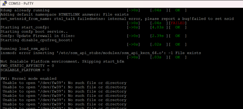

However, this week, while trying to configure a 19100 firewall running R82 JH 91 with KPPAK, I faced the error below, and the firewall entered a boot loop freeze, even though sk179432 still describes support for it.
Below Error encountered during boot when changing a 19100 firewall from UPPAK to KPPAK:
I switched back to UPPAK and the firewall is operating normally again, so I got important information that I think is worth sharing.

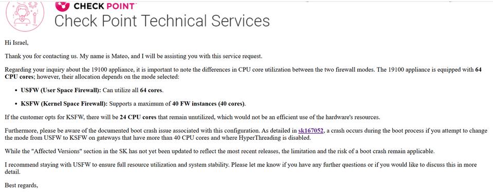

The sk167052 – “User Space Firewall (USFW) support on Security Gateways” documents that:
  • KPPAK will no longer work starting from R82.10
  • Firewalls with more than 40 CPUs, with or without HyperThreading enabled, may or can experience boot crashes
    Below is the response from Check Point:
It is important to prepare for this scenario. Those who previously had major issues with UPPAK freezing firewalls, buffer overflows, and environments stuck in a “no solution” situation where the only workaround was switching to KPPAK — whether on older firmware/firewall generations or even newer platforms — should be aware and prepare for this major definitive change that is coming. On high-end platforms like the 19000 and 29000 series, it seems we will fully move forward with UPPAK only.
