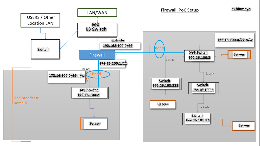

As previously we using L3 Switch (Name: POC L3) where 4 interface which comes from two internal switches (ABC and XYZ Switch) is terminated with upstream L3 Switch (Name: POC L3) internal VLAN interface.
➡️ Two internal switches (ABC and XYZ) both having one bond interface with mode LACP.
➡️ On Checkpoint external interface also having a bond interface with network 192.168.100.0/22.
➡️ Our requirement is to place Checkpoint Firewall (23500) in between internal switch (ABC and XYZ) and L3 Switch (Name: POC L3).

Scenario 1
As per our requirement, we can not add two bonds on one VLAN, If we added then it will be creating two networks, for example, bond1.100, bond2.100 with respect to VLAN 100.
➡️ So we added 4 interfaces to one BOND as bond1 with mode LACP and then create a VLAN and added that bond1 but we face the issue because all interface is active because of mode LACP.
➡️ So on this scenario, If we remove the cable from any one internal switch, for example, ABC switch then XYZ switch working fine, we able to access server as well ssh from LAN/WAN.
Scenario 2:
As the first scenario does not work as expected so we change the configuration.
➡️ We create a two BOND, bond 1 and bond 2 with respect to the internal switch and then bridge between bond 1 and bond 2 so in this scenario, we only assign one IP address on the bridge interface as 172.16.100.1/22 which meet our requirement.
So in this scenario we able to ping internal server that behind ABC and XYZ switch.
Issue:
➡️ we check the logs found that the packet drop on Checkpoint internal bond interface, showing error "missing OS route".
➡️ Base on the logs I suspect as the ARP cache is overflowing. The most possible reason - too much traffic on the network (generated by some application, by some hosts, or by related factors). (sk108587 )
➡️ By default, the arp cache size is 4096 ARP cache slot so maximum we can increase up to 4096*4=16384 arp cache slot.

@Chinmaya_Naik , the problem, as I see it is the presence of a huge flat network that you are trying to split, possibly for the lateral traffic inspection.
To address the "missing OS routes", try going into WebUI, Advanced Routing / Routing Options / click to select on “Kernel Routes” and "Apply".
If you must allow broadcast traffic propagation between networks behind different interfaces/bonds while simultaneously attempting to route traffic to other networks, you have to use bridge and will, inevitably, suffer the huge ARP table, as well as associated performance deterioration.
Since you are still experimenting and seem to have two gateways, try using one unit in the 3-way bridge and another one as a routing gateway. Drop the broadcast traffic on the bridge towards the routing gateway to avoid ARP overload and see if it works.

As per our network architecture, it seems to be arp issue because the internal network is on one broadcast domain 172.16.100.0/22 and also we configure the Bridge interface where we added two bonds (total 4 interfaces).
So we change our plane.
New Plane v2
We revise the changes on the current diagram and introduce a new switch in between Checkpoint Gateway and internal Switch (ABC and XYZ), where
The new switch will handle flat network traffic. (Broadcast)
We make Checkpoint gateway inside interface 172.16.100.1/22 as the default gateway for all North and South traffic Inspection.
But still, as the internal network still have one broadcast domain so still the checkpoint maintain the ARP but we avoid the bond interface related challenges.
