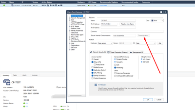

Kindly guide us how to enable SIC for R81.20 Gateway standalone appliance.
Am trying to add my gateway with management server via smartconsole SIC Trust getting failed please find attached screenshots.
Guide us. whether SIC option is showing in R81.10 Version?

It looks like that was set up as a standalone with primary management. Only managements have a "GUI Clients" section in cpconfig. Secondary managements still have a Security Internal Communication section, and this one does not.
You probably need to rebuild the system and specify only firewall in config_system or in the web UI.

What Bob told you makes 100% total sense. As standalone, you will never get that option, specially if its set as primary mgmt.
My lab:
[Expert@CP-TEST:0]# cpprod_util FwIsActiveManagement
1
