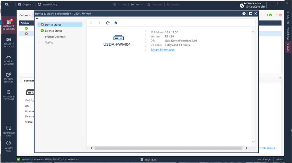

Following the same process, I have installed them with a temporary license for both and while Management shows GREEN in SmartConsole, the LogServer is with RED. Still in the Alert tab I have nothing.
If I check the Device Status, I have nothing, not even the service status:

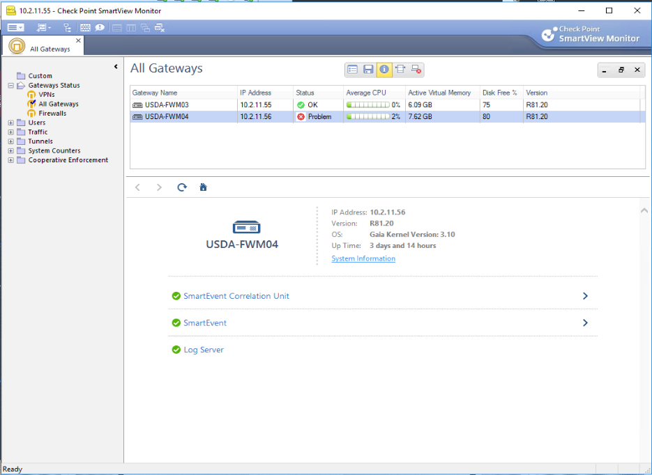

But what confuses me more, is that in SmartView Monitor, I see Log Server with "Problem" but here I can see services, all GREEN.
Also I have run cpdoctor.sh and no issues were seen.
I have re-installed Log server twice from OVA, I did not tried to deploy it from ISO (I will do that too but did not had time), still I would like to understand what is it seeing as an erorr and triggers those RED errors.

As an update, the engineer from TAC pointed me to sk129632 .
I've restarted CPD services on Management (previously I only did it on Log Server) and now it's ALL GOOD 😉 .
