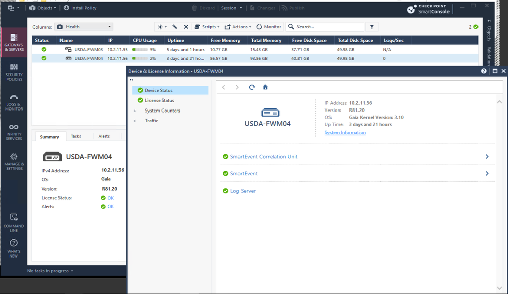

Following the same process, I have installed them with a temporary license for both and while Management shows GREEN in SmartConsole, the LogServer is with RED. Still in the Alert tab I have nothing.
If I check the Device Status, I have nothing, not even the service status:

As an update, the engineer from TAC pointed me to sk129632 .
I've restarted CPD services on Management (previously I only did it on Log Server) and now it's ALL GOOD 😉 .
"From the case description, I could understand that you are facing an issue with  error in Smart Console.
As the symptoms match the below sk129632, please try to perform the steps mentioned and  let me know the status.
https://support.checkpoint.com/results/sk/sk129632 "
