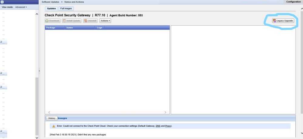

So i just installed a fresh 4800 out of the box which comes with R77.10 , for some reason it cannot find any updates via gui so the only option left is to upgrade using the legacy upgrade option at the top right, now i need the correct R80.20 image for this, if someone can share the link with the correct R80.20 image that would be great. Came across this link- https://supportcenter.checkpoint.com/supportcenter/portal?action=portlets.DCFileAction&eventSubmit_d...
Is that the right link for R80.20 image?

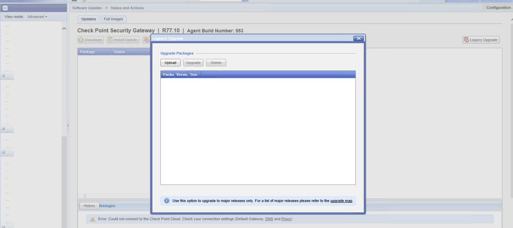

Also attaching the images of the legacy upgrade option below-
Some info about the firewall-

R77.10 is way End of Support.
To get the updates from CPUSE, you'd have to likely manually install the latest Deployment Agent, which may or may not work.
Your best bet is to use ISOmorphic to install the relevant ISO to a USB drive then boot from the drive.
This will install the platform fresh with the relevant version.
Boaz_Orshav
Employee
Employee
Adding to above - even if the Deployment Agent works on this version, no 80.20 packages will be presented.
Since this is a new machine there is no advantage in upgrade - it will just consume disk space (creates a snapshot) and it is not verified since 77.10 is long out of support.
Indeed ISO seems like the best (or maybe only) way in this case
