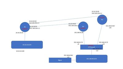

Hi Team,
My scenario is as follows and the issue I faced is when the bgp routes are checked on firewall one of the path show as Inactive. I tired debugging with trace options but I unable to crack through. Am I missing something? may be another pair of eyes can help me here?
Here are the route and BGP status on firewall

In fact my entire path is through one link but unable to achieve the redundancy through another link.

The issue in the OP's screenshot is that routes are fine, it's the additional less-good routes that will be inactive.  This is doing to be due to the BGP path-selection algorithm.  In this case, it looks like all attributes were equal, so it came all the way down to the end: the RID (router-id).  BGP chooses the lowest RID when determining which path to install into the FIB.
In this case, 192.168.20.60 was the lowest RID (assuming the peer is using its advertised IP as the RID and it wasn't manually selected differently).
