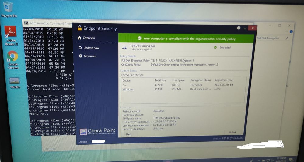

STEP 1: First we check the current UEFI boot mode on Encrypted Machine by going to this location (%ProgramFiles(x86)%\CheckPoint\Endpoint Security\Full Disk Encryption) and run the command "fdecontrol.exe get-uefi-bootmode"
and we see the current boot mode is "BOOTMGFW" so on Next step
STEP 2: We change the boot mode to "BCDBOOT" by command "fdecontrol.exe set-uefi-bootmode bcdboot".
STEP 3: We change in FD policy and off the "Pre-Boot Environment for FDE" and tested by rebooting the machine.

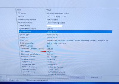

Machine A = Windows 10 build 1083
Machine B= Windows 10 build 1809

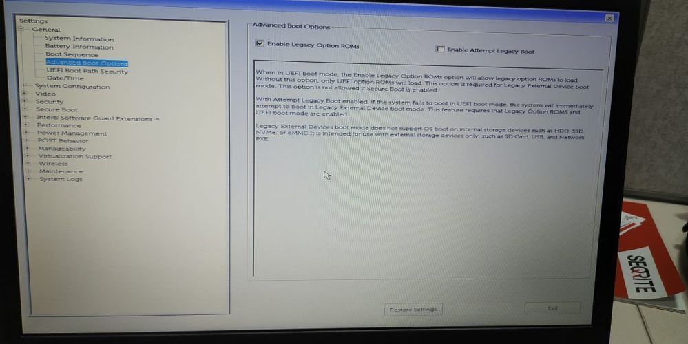

We upgrade to windows 10 build 1903
Switch to BCDBOOT not required because we use legacy BIOS.
Change the FastBoot to Minimal.
BIOS Update Done Successfully.
