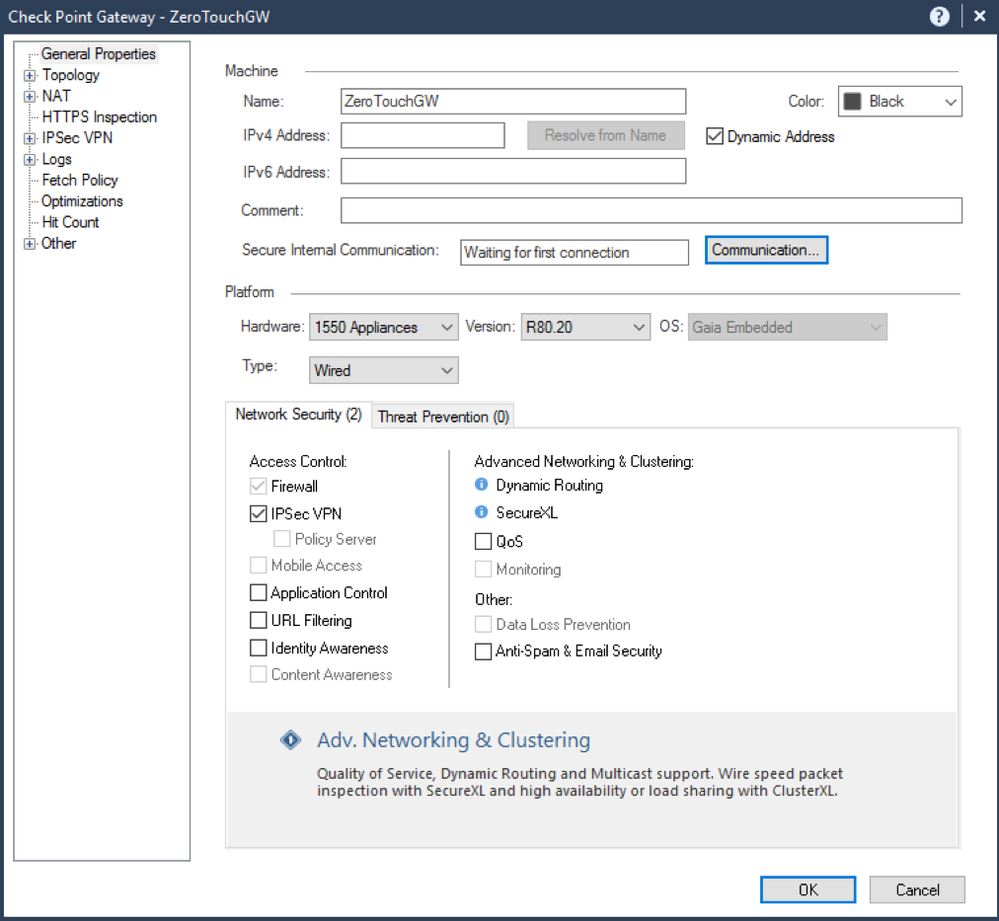

1. Create a Gateway object in Smart Console, and configure the hostname (do not use underscore), IP address (in most cases, it will be a dynamically assigned IP address, in this case the Dynamic Address box will be checked, otherwise, the specific IPv4 address will be specified), hardware and OS version (make sure the version is R80.20 Gaia Embedded)
2. Prepare the SIC password so that the gateway can connect to the manager for the first time. Click on Communication option. Enter the SIC password and check the option to Initiate trusted communication automatically when the Gateway connects to the Security Management Server for the first time, as shown in the following image.
3. Once completed, the status of the SIC in the Gateway object will be as follows: Waiting for first connection:
4. Publish changes and Install policy on the new 1550 appliance. This action does not actually install policy, but leaves it ready for when requested by the 1550 appliance. The 1550 appliance can also be configured as the ‘Installation target’ of the Policy Package.
