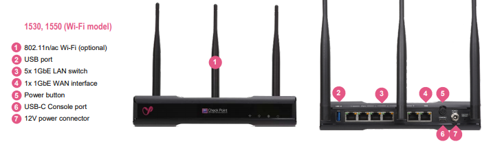

- Connect power. The Information LED marked with the
_Val__12-1628672160968.png character on the front of the appliance turns steady blue when the appliance is ready.

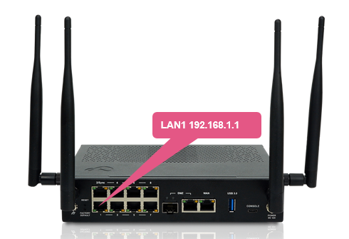

- Connect your PC to the LAN1 port at IP address 192.168.1.1 for initial setup. On your PC enable DHCP or set a static IP address in the 192.168.1.0/24 network other than 192.168.1.1.

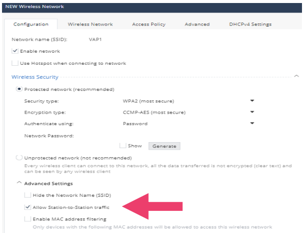

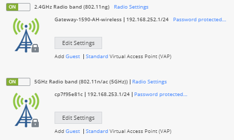

- Optionally configure the Wireless Network. The default the authentication method is WPA/WPA2 PSK. Click Next.

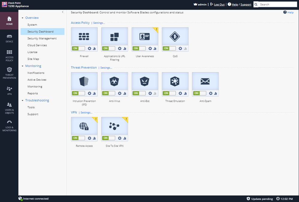

1500 Appliance Security Dashboard

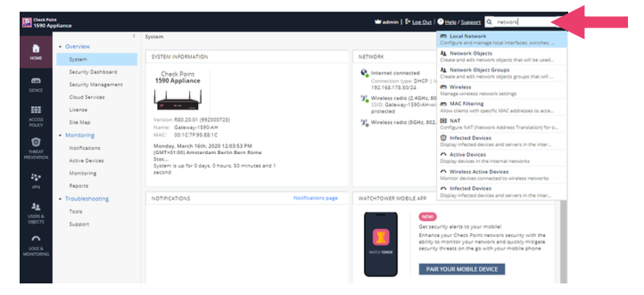

- The search bar takes you quickly to a configuration page. For example type these words into the search field; firewall, log, user, network and application. Notice the pages available and select needed one by clicking it.

- Type Dash in the search field and press enter. The Security Dashboard is displayed. From this page you can see which security features are enabled, status messages, jump to a configuration window and view the overall activity status.

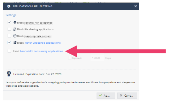

- To disable a security feature drag the slider bar from ON to OFF. Locate Applications & URL Filtering and drag the slider from ON to OFF and then back to ON again.
- In the Security Dashboard it is also easy to modify the security policy and view an overall status. Locate the Gear and Graph icons. Click on the Gear icon in Applications & URL Filtering.
- Notice that the default Applications & URL Filtering policy Blocks the security risk categories. Click on security risk categories, inappropriate content and torrents and P2P applications to review each. Notice that these three are all predefined and not editable. Finally enable Block other undesired applications by checking the checkbox. Select Alcohol to block access to Alcohol related sites. Press Apply. Press Apply again and the security policy is changed. To test the configuration, try browsing from an internal host to www.budweiser.com.

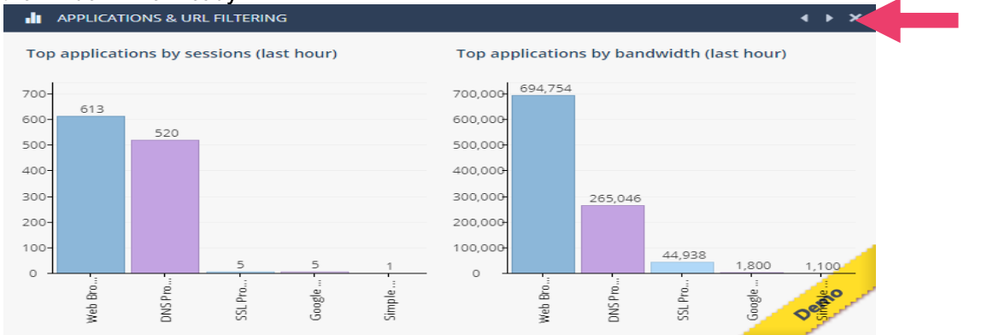

- In the Security Dashboard locate the Graph icon in Applications & URL Filtering. Click on it to see the overall activity. Click on the Arrow pointing to the left to see the Firewall Blade Activity. Or click view demo. Press X to close the window when ready.

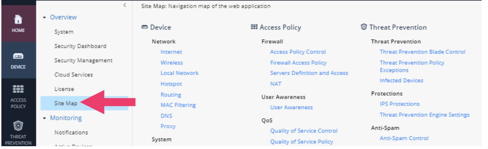

- Before leaving the Home tab, click on Site Map. Notice that there are 6 categories which correlate with the remaining 6 tabs; Device, Access Policy, Threat Prevention, VPN, Users and Objects and Monitoring. In each category are the pages available to the user. This is another way to navigate to the page you want.

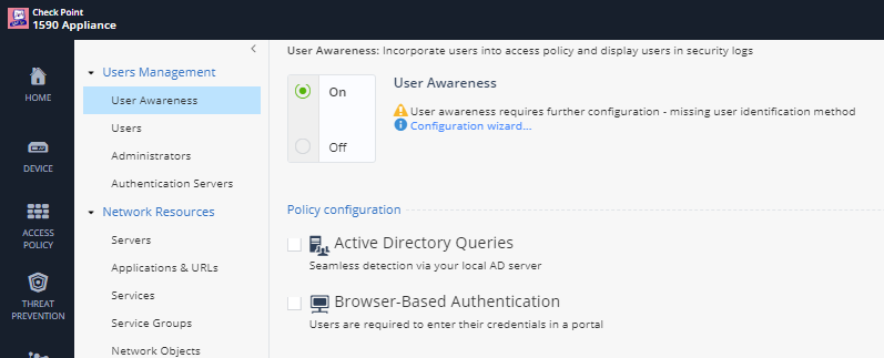

Other components of a Next-Gen firewall like User Awareness and Application Control are configured in the Access Policy tab as well. We have seen the default Application and URL Filtering policy. URL Filtering is combined with Application Control to simplify policy management.

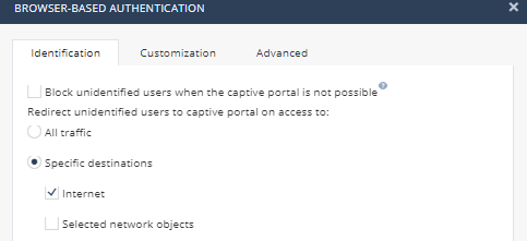

Two types of User Awareness are available; an Active Directory integration and a Captive Portal. The default Captive Portal setting is to capture Internet bound traffic.

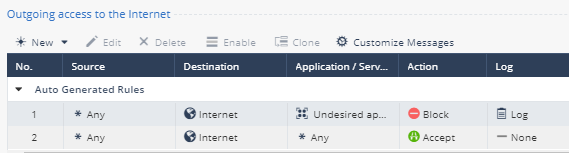

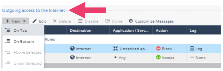

The combined Next-Gen firewall policy is visible in Access Policy -> Blade Control -> Firewall Policy.
- In the search field enter firewall and select Firewall Access Policy. Notice that the policy is predefined and separated into two sets of security rules; Outgoing Access to the Internet and Incoming, Internal and VPN traffic.
- Double click on the second outgoing security rule. Notice that the only field that can be edited is Logging. Also notice that the rule accepts all outbound connections.
- Click Cancel to return to the policy. When a packet is inspected, the inspection is done from the top down starting with the first rule in the policy. The first match is applied. Notice that the Action of the first rule is Block.

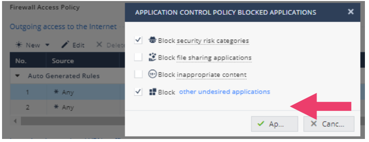

- Double click on the first rule to edit it. Notice that this rule blocks Undesired Applications and that the Action Block is not editable.
- Click on Undesired Applications. Notice that Block other undesired applications is enabled from the first part of the exercise. If you like, click on other undesired applications and you should see that the category Alcohol is still checked. Click Cancel to get back to the base policy.

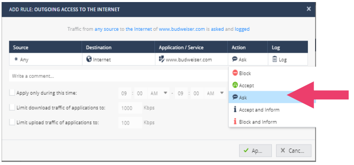

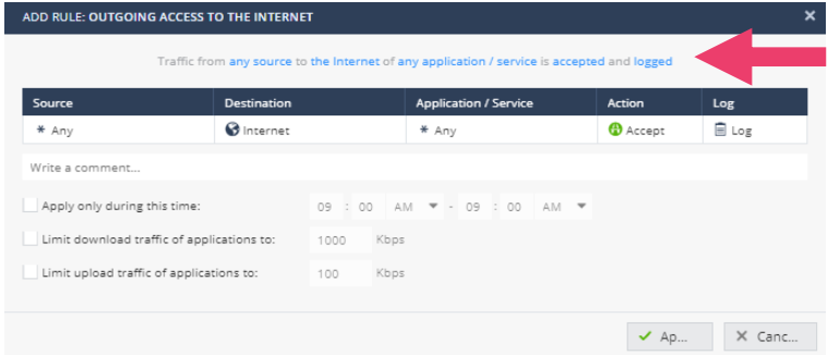

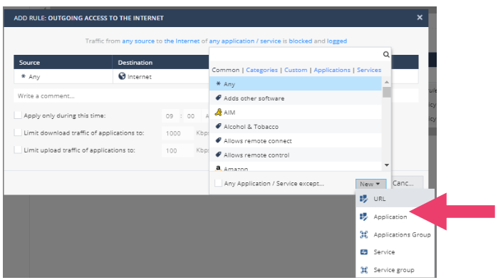

- Let’s modify the outgoing policy. What if we want to allow connections to the www.budweiser.com site, but block connections to other Alcohol related sites? Since inspection is done top-down, we can create a rule that allows this connection at the top of the policy. Click New and select On Top.
- Notice that all of the fields can be edited. Click on any applications -> New and select URL.
- Enter the URL www.budweiser.com. Click Apply.
- Notice that the default Action is Block. Click on blocked and select Ask. Click Apply.
- Test the policy by browsing again to www.budweiser.com. This time instead of a Block page you should see the Ask page. Note: The default is doing categorization in the background, which means the first time a site is accessed it may not be blocked, but will be blocked on subsequent page visits. This default behavior can be changed.

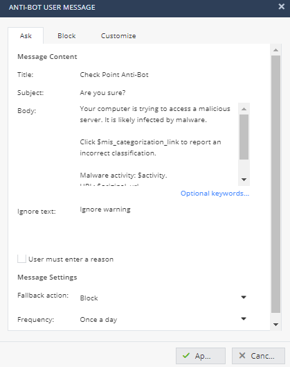

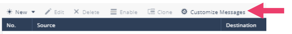

- These messages are customizable. Click on Customize Messages and view the messages that users receive for the actions; Ask, Accept and Inform and Block and Inform.

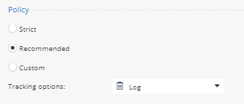

Policy Settings | IPS
- Click on the Threat Prevention tab. Click Blade Control. The Threat Prevention Blade Control is displayed. Notice there are 3 policy options; Strict, Typical and Custom.
- Click on Custom to enable the configuration and click on configure. With this policy an IPS protection will be activated according to the protection severity, confidence-level, and performance impact. This is an easy way to modify your IPS instance based upon these three parameters. Click Load default settings and select a strict policy to see how the protection levels are set.

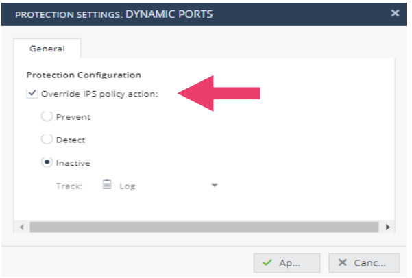

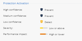

- Click Threat Prevention, Protections, IPS Protections. A list will be displayed. Double click on a protection. Notice that you can override the default action.
- Click on IPS Engine Settings. Notice that by default IPS inspection is done to protect internal hosts.

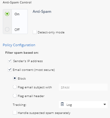

Policy settings | Anti-Spam
- Anti-Spam provides e-mail protection based on IP reputation, block/allow list, content-based and zero-hour outbreak protection.
- Click on Anti-Spam Blade Control. Notice the default settings.

Anti-Bot blocks connections to Command & Control Servers. Helping you to identify infected systems.
- Notice the default settings.
- You can configured if needed, Ask.

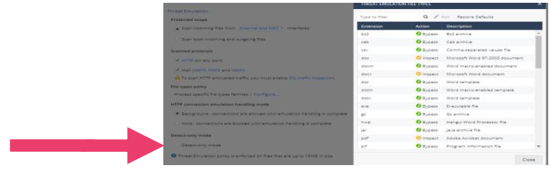

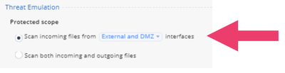

Policy Settings | Threat Emulation

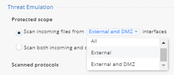

The 1500 series Appliance supports threat emulation handling for SMP, IMAP/IMAPS and POP3.
- Click on Threat Emulation Blade Control. Notice the default setting: scan incoming files from External and DMZ interface.
- Click on file types. Select the security that matches the requirements.
The default HTTP connection emulation handling mode is background.

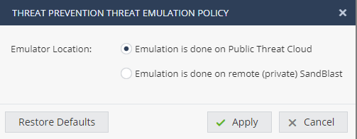

The 1500 Appliance also supports a Private Threat Cloud. With this setup an on-premises SandBlast Threat Emulation, TE appliance will be used for emulation.
The TE Appliance IP address can be configured via the WebUI.

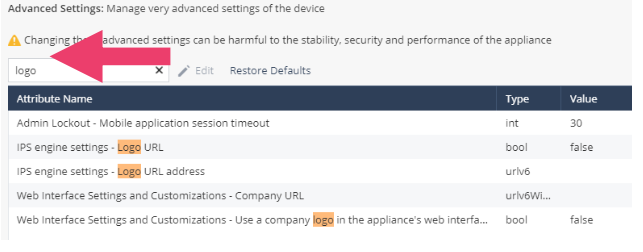

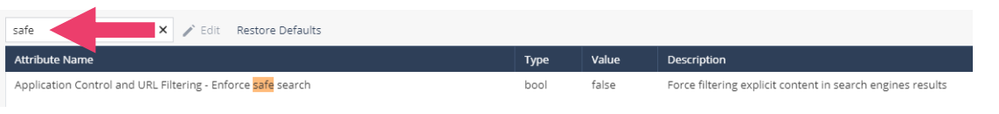

- Click on Device -> Advanced -> Advanced Settings. Search for Threat Emulation.
Note: Default Public Threat Cloud
- The up following TE Appliances need to be configured via CLISH. CLISH is a default shell of the CLI, Command Line Interface.
set threat-prevention threat-emulation policy emulation-location remote primary-emulation-gateway <IP address>

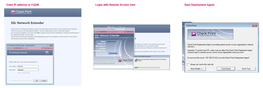

SSL VPN
Supported Endpoint Windows, Mac OS X and Linux platforms Java Availability
sk65210
sk65144

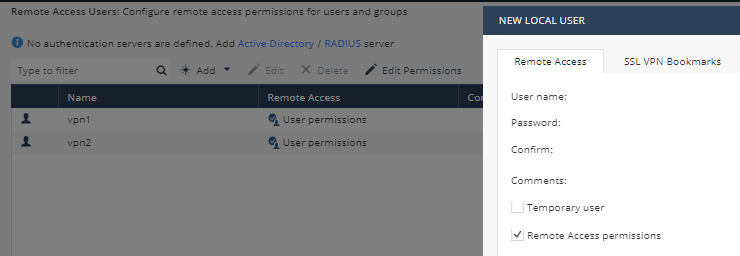

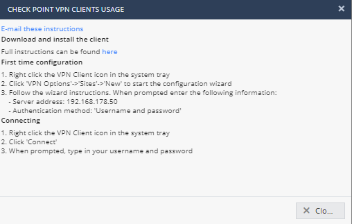

- Click on VPN -> Site to Site -> VPN Sites. Click on New. Notice Authentication may be done by using Pre-shared keys or Certificate. The default Encryption Domain is set according to the network topology to facilitate VPN configuration. Click Cancel.

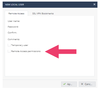

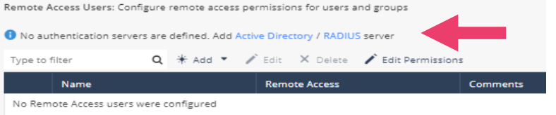

- Click on VPN -> Remote Access -> Blade Control. Notice that there are 4 options for Remote Access.
- Click on Check Point VPN clients Usage. Notice the instructions for setting up the Remote Access Client can be emailed to users and a link is provided for downloading the client. No special credentials are needed to download the client or the client documentation. Click Close.
- Enable SSL VPN and Windows VPN client if desired. Click on SSL VPN Usage. Click on the Connection instructions link to see how to connect via SSL (SSL Network Extender). Click Close.
- Click on VPN -> Remote Access -> Remote Access Users. Click Add -> New Local User. Notice that Active Directory and RADIUS authentication is supported.

The 1500 Appliance includes User Awareness. It provides the ability to create security policies based upon users or IP addresses and ports. In the Users & Objects tab local users and remote user solutions like Active Directory and RADIUS can be configured. Same goes for network objects, services, and applications.
- Click on Users & Objects -> Users Management -> User Awareness. Click on Configuration Wizard.
- Notice there are two options; Active Directory Queries and Browser-Based Authentication. Enable BrowserBased Authentication. Notice “Block unidentified users when captive portai is not possible and “Redirect unidentified users to captive portal on access to”

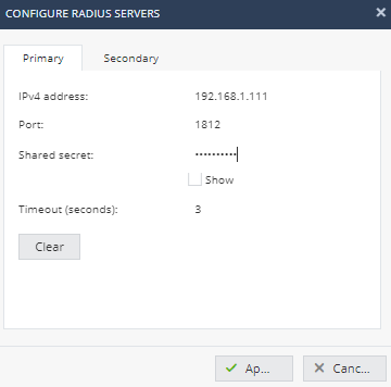

- Click on Users & Objects -> Users Management -> Administrators. Notice that RADIUS authentication is an option.

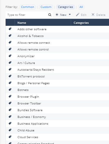

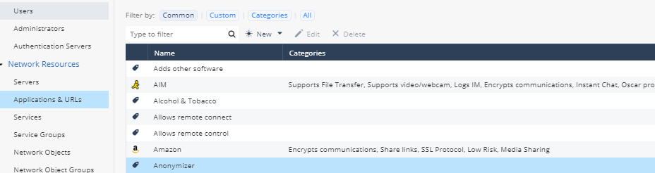

- Click on Users & Objects -> Network Resources -> Applications & URLs. Click All. Notice that there are over 6,000 Applications that are available in the security policy providing granular control.
- Click Categories to show the Application & URL categories. Notice how easily you can create a security policy that is categories.

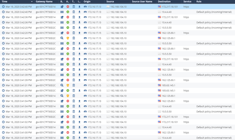

The 1500 Appliance includes a Google-like search through security and system logs. Here you can also view active computers, view high risk security events, high bandwidth users, applications and generate hourly, daily, weekly and monthly reports. In addition you can create a diagnostics file or packet capture.
- Click Logs -> Options. Notice that in Security Logs there is an option to safely eject the SD Card. The appliance has the option to save logs to an SD card of up to 32 GB.

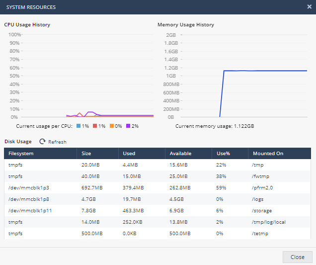

- Notice that in Diagnostics there is a tool to Monitor System Resources, Generate a CPinfo diagnostic file and create a packet capture file for support and the ability test cloud services ports. Click on Monitor System Resources.

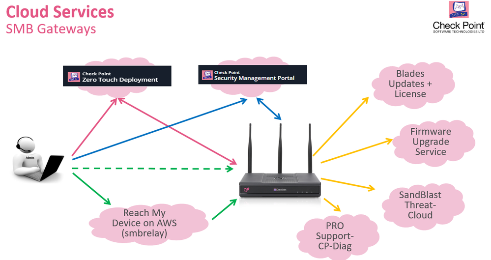

Cloud Services | Security Management Portal, SMP
The Security Management Portal simplifies the deployment and maintenance of Check Point SMB gateways using group-based management tools. Administrators define multiple service plans, each consisting of a template that defines the plan’s expiration date, gateway properties, VPN settings, as well as additional services such as Anti-Virus protection and content filtering. Plans can be associated with an unlimited number of SMB gateways which inherit all of that plan’s properties. Specific aspects can be overridden if required. When the administrator updates the plan, the changes are automatically applied to all associated gateways.
Log, Report, Monitor and Alert
Security reports can be rebranded, automatically generated and emailed to customers at predefined intervals and can also be viewed directly from the SMP management interface. Security reports include information about blocked attacks, detected viruses, filtered web sites and more. In addition, SMP offers powerful real-time monitoring tools, showing the status of connected devices at a single glance. You can use real-time alerts and notifications to proactively support your customers and notify them of connection outages, VPN tunnel drops or attacks, all before the customers become aware of these problems. In network analysis you can find top applications and users consuming the most bandwidth. Security analysis shows users visiting high-risk sites and using high-risk applications. You can also view incidents or infected hosts found during the reporting period.
Automate Firmware Updates
Ensuring that hundreds of gateways all enforce the highest level of security can be a daunting administrative task. To address this problem, Check Point SMB gateways use a “fetch” technology for automatic and scheduled firmware updates: gateways automatically detect and download new firmware whenever it becomes available on the management server, instead of the management server initiating communications with each individual gateway. This reduces the load on the management server. In addition, updates can be scheduled to minimize gateway downtime, and administrators also have the option to override group settings and push unique firmware and settings to specific gateways.
The cloud-managed service, Security Management Portal, SMP you can manage the security policy, firmware upgrades (gradual and remote scheduled), Cyber Views and periodic backups. Key benefits of the SMP:

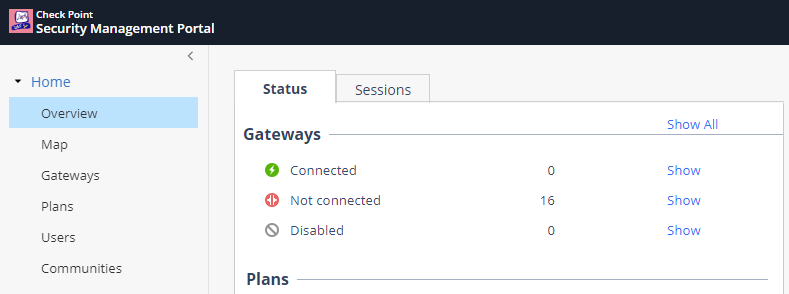

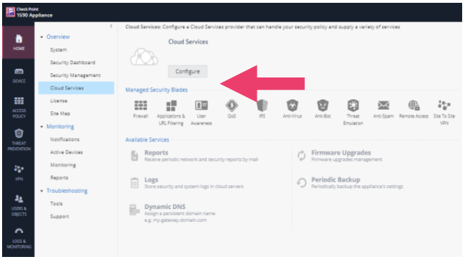

Below is a screenshot that shows the customer view and the features.
- Click on Home -> Overview -> Cloud Services. Notice the options for managing the 1500 Appliance.
- When a customer is registered an email is sent with instructions how configuring the Cloud Service connection.
- For Internet Service Providers (ISPs) and Managed Service Providers (MSPs) the cloud-managed service offers an interface to manage and support thousands of their customers easily and intuitively. This includes security policy management, firmware upgrades, automatic backups, periodic reports and VPN community support which is essential when using these appliances in the retail sector. Key benefits of the service to ISPs and MSPs are;

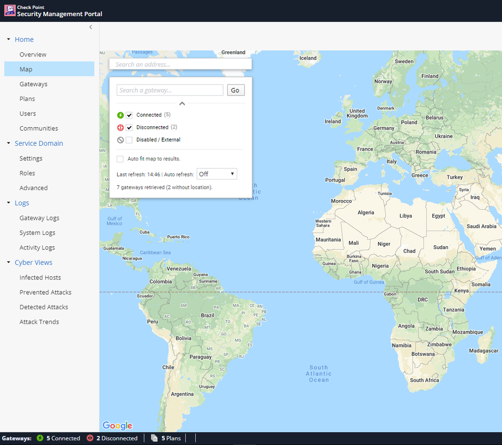

- When administrators login to the site, they’re presented with an overview of the managed devices.
- Click on Home -> Map. A map is displayed of the managed devices. Click on Gateways to see a overview of all managed devices, the device owner and the plan assigned to the device.

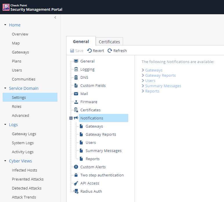

- Click on Service Domain -> Settings. Here you can set notifications, logging options and DNS settings.

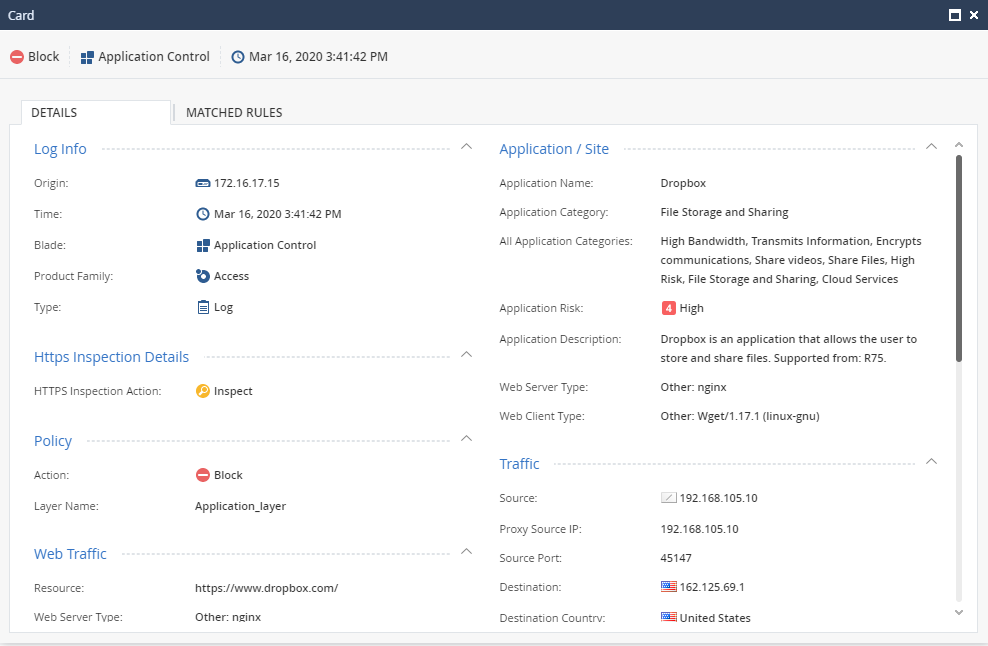

- Click on Gateway Logs -> Logs. Here admins can monitor and investigate incidents. The search bar is a “Google-like” search engine that help sort the logs.
- Double click on the log. The log card shows useful information on that specific transaction.

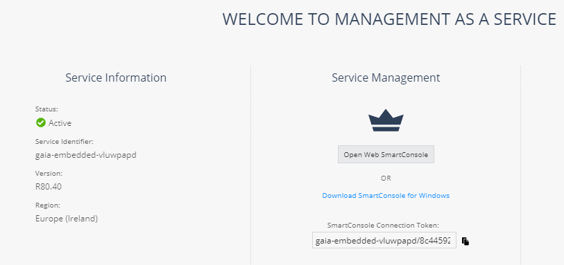

MaaS | Management as a Service
- The 1500 Appliance supports MaaS for central managed appliances. Management as a Service is a new Software as a Service solution for Security Management. Instead of deploying and maintaining a Management server, customers can connect to our new service and manage their on-premises gateways. Setup is very easy and can be done by registering to portal.checkpoint.com. With no start up efforts, no installation, no deployment and no upkeep.
Key benefits:
- Elastic growth
- Infinite logging
- Always up-to date
- Zero maintenance

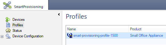

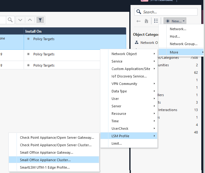

LSM | Large Scale Management
LSM and SmartProvisioning lets you manage multiple gateways from one Security Management Server, SMS or MDS. SmartProvisioning defines, manages, and provisions meaning, remotely configures large-scale deployments. In Central Management environments with SMB domain and updatable objects are supported.
SmartProvisioning helps you manage the load on the Appliances.
The policy is not installed on all Appliances simultaneously, but the Appliances fetch the policy at different time intervals. The SmartProvisioning management concept is based on profiles, which help you manage your gateways more efficiently. With these profiles, you can define the gateway settings once and then assign each profile to multiple gateways, as needed. For example, when you select which blades to enable in the LSM Profile, the selected blades are enabled on all gateways which are assigned to the Profile.
SmartProvisioning supports two types of profiles: Security Profiles, which define the security settings, and Provisioning Profiles, which define the device settings. SmartProvisioning is efficient for use in large enterprises with many branch offices, where the branch offices have identical or similar characteristics. You can use a relatively small number of Security Profiles or Provisioning Profiles to manage a huge amount of Appliances.

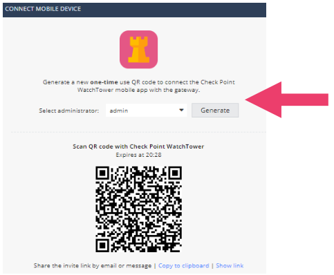

- Install the WatchTower app on your mobile phone
- Click on pair your mobile device. Select the relevant administrator and generate the QR code. The QR code can be shared with an invitation link via email or message.
- Notice the management of administrators, security updates and assign contacts.

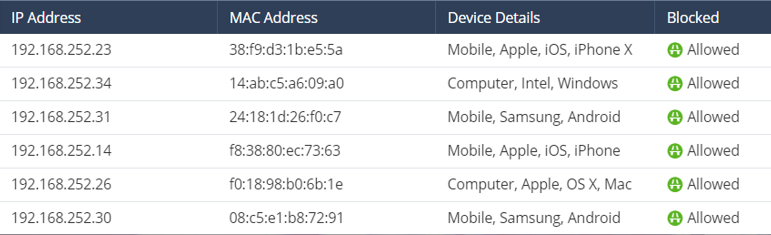

IoT Device recognition and discovery
The 1500 Appliance offers Device Recognition and Discovery. Find all connected devices in your network.

- Click on Device -> Network -> Wireless.
- Notice that this option provides the ability to have multiple wireless networks. This may be useful if you want to have one wireless networks for employees and one wireless network for guest access. Click Add a Standard Virtual Access Point (VAP).
- Notice there is an optioin to enable a Hotspot. When enabled this option redirects users to the Hotspot portal. You can configure the Hotspot portal with your own company logo.

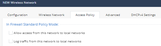

- Click on the Access Policy tab. Notice that Allow access from this network to local networks is checked. For a guest wireless network you may want to disable this. Click Cancel.

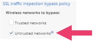

- Click on Access Policy -> SSL Inspection -> Policy. Notice the default HTTPS Categorization. This functionality allows URL filtering for HTTPS sites and applications based on server’s certificate, without activating SSL traffic inspection.
- Click Access Policy -> SSL Inspection -> Policy -> SSL traffic inspection. Notice the CA certificate needs to be downloaded for deployment of SSL inspection.
- Default untrusted networks are excluded.

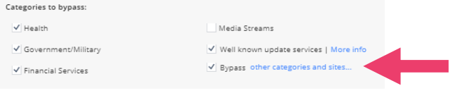

- Notice the bypass categories and click bypass other categories and sites
- Click bypass other categories and sites, if you wish you can add new URL’s or applications

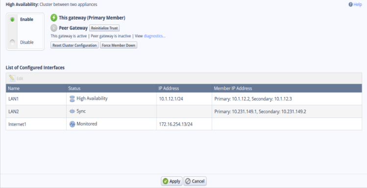

Clustering/High Availability
You can configure two appliances in a cluster configuration for High Availability. High Availability maintains connections in the organization's network when there is a failure in a cluster member.
Only one gateway is active. When there is a failover, the standby member becomes active, providing 100% availability.

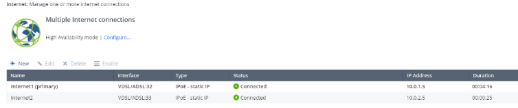

ISP Redundancy
We all become dependent on internet connectivity. Uninterrupted internet access is mission critical. Check Point Supports two types of traffic distribution: Load Sharing and High Availability. Connection monitoring can be done on recovery time, maximum latency allowed, probing frequecy, pings and failover pings.

- Click on the Device -> Advanced -> Advanced Settings.
- The search bar takes you quickly to the desired configuration option. Search for logo.
- Notice you can upload your own Company logo quite easy.

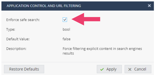

- You might want to enable Safe Search to enforce filtering of explicit content in search engines.
- Enable this functionality by clicking the checkbox.
