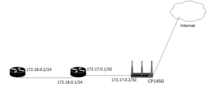

In this environment we have on Checkpoint 1430 with a local 192.168.1.1/24 network and 2 virtual Cisco routers (GNS3) simulating an MPLS network.

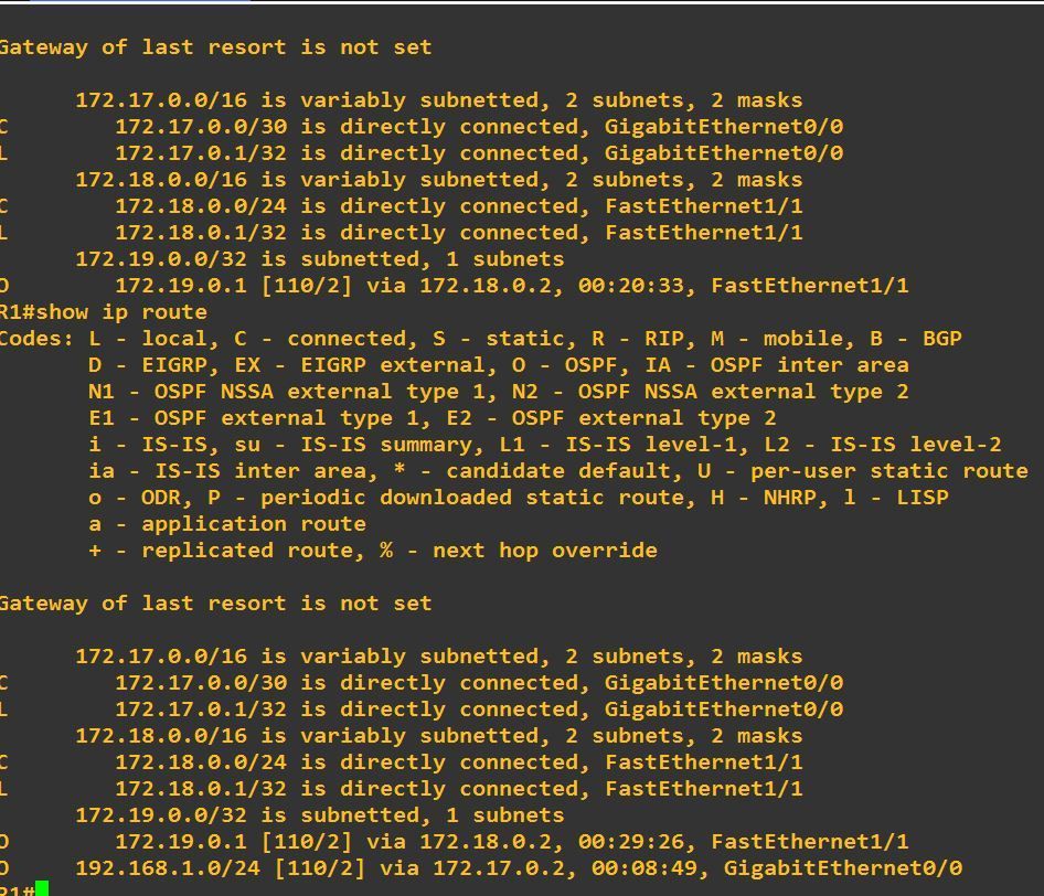

At the end of step 2b the CP1450 and a properly configured Cisco router will establish a neighbor relationship and exchange routes. As demonstrated via the ‘show ospf neighbors’ output from the cp1450, we have an FULL/BDR relationship with 172.17.0.1.
However from the Cisco side we don’t see the local 192.168.1.0/24 network and need to add the ‘set ospf area backbone range 192.168.1.0/24 on’ command. This command is allows the Checkpoint gateway to advertise known networks that fall within the Range in the command. See below, the first show ip route command doesn’t have the 192.168.1.0/24 network and the second is after adding the OSPF range command to the SMB gateway.
