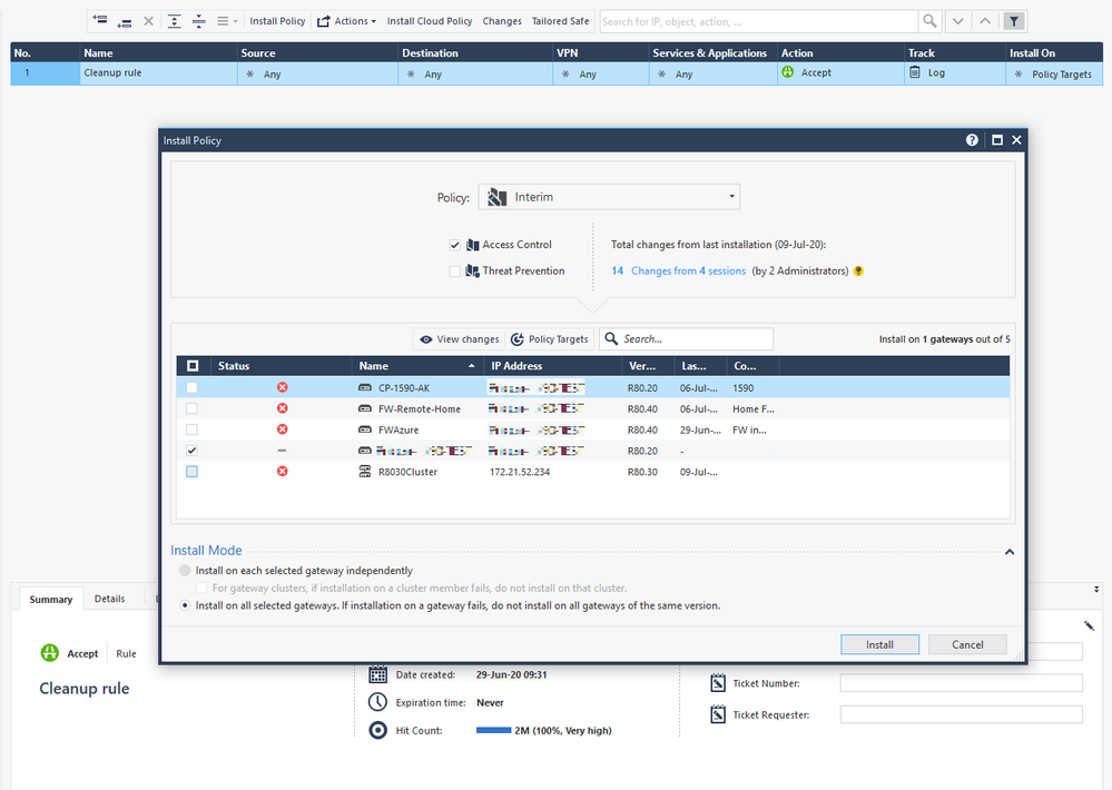

Then navigate to the Smart Console and establish SIC (use key entered during the first time config wizard).
- Let the Management server complete the information gathering from the Appliance.
- You can confirm the maas status from the CLI (Shown below).
- Once completed you should be able to successfully push policy to the SMB appliance from the Smart console.
