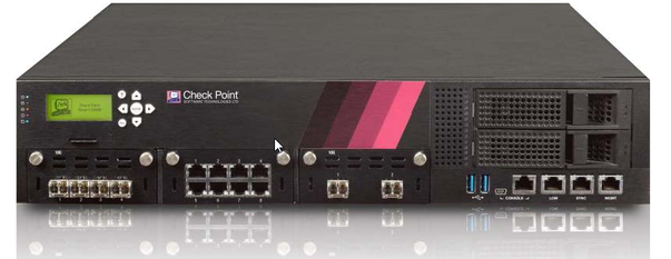

I got a simple question... can someone please explain what is the reason for having a " - " signal on a interface? I'm reading a configuration and noticed that several interfaces are configured this way:
set interface eth1-01 state on
set interface eth2-01 state on
set interface eth2-05 state on
set interface eth2-06 state on
What does that actually mean and what makes it different comparing to simple interfaces like eth1, eth1.100 (VLAN), bond1, etc?

When you have an appliance which has interface modules such like 15600:
eth1-01 is then first port of first interface module and so on.
