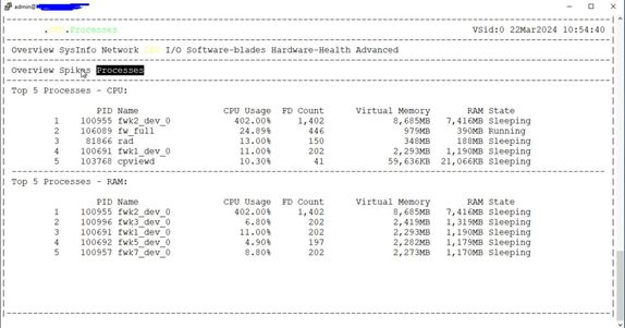

Dear Checkmates,
I have some questions regarding cpview. I have running a 26000 appliance with R81.20 + JHF-53 with VSX.
In cpview -> CPU -> Processes, the process fwk2_dev_0 uses more than 400%.
 Is this due to the fact VS2 has more than on cpu core?
VS2 has 16 core assigned.
The value is incressing. Is this only an output for the max value?
Best reagard,
Christian

Yes, 400% is because it is running on 16 cores in your case. Not so bad, and not a concern at this point, 25% per core on average.
Those are average numbers though. if you want spikes, it is a different menu.
