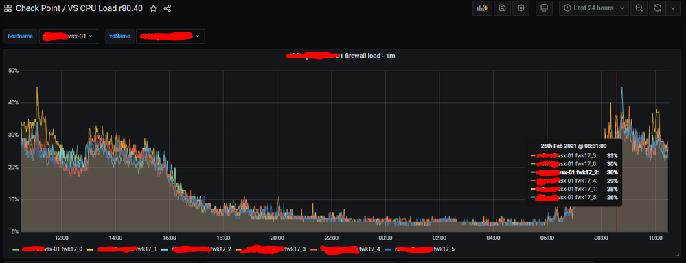

Actually you can pull all process load for a given VS. We do this with: CHECKPOINT-MIB::fwInstancesCPUTable
This allows us to graph each VS individually and collectively, see below:
All VS share the same some 24 cores and 8 SNDs
fwk load of a VS with 5 cores assigned
all VS fwk load SUM'ed per VS
VSX load
fwk 5 cores
all VS on cluster fwk load
general VSX load

Hey,
I poll each VS through the VSX DMI. Use snmp v3 with the flag -n ctxname_vsid17 - to poll a specific VS through the DMI.
The oid is there. Check the official mib in sk90470 (I use r80.40)
But without knowing prtg I can only recommend to look into a TIG stack - Telegraf/InfluxDB/Grafana solution. It will improve your monitoring level many times.
I have attached a telegraf config to get you started for single VS monitoring.
