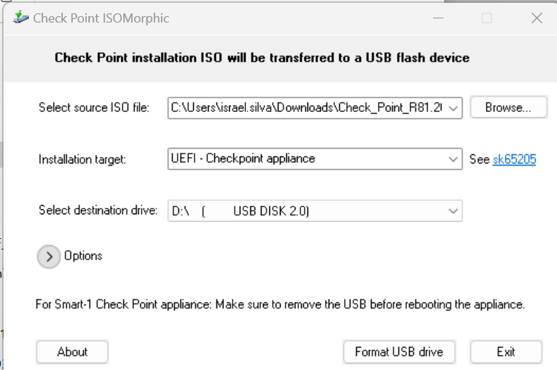

1 - Download new version of isomorphic build 207
https://support.checkpoint.com/results/download/129714
2 - Create USB drive using isomorphic build 207 SELECTING UEFI - Check Point appliance option

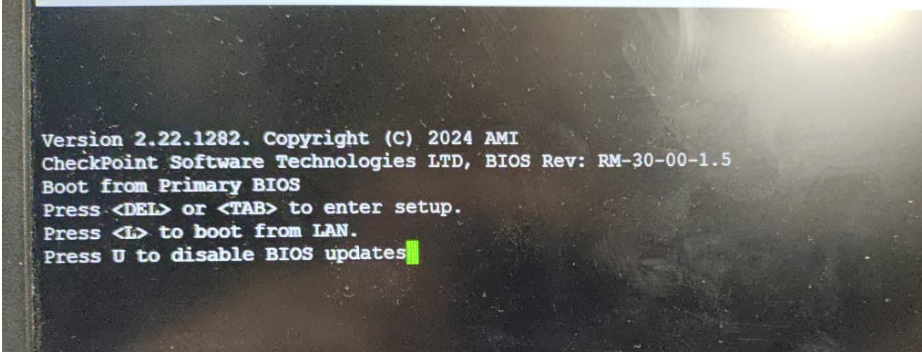

3- Plug USB drive on Security Gateway, and reboot the Security Gateway or turn on
4 - Don't select any option here, JUST WAIT firewall recognize the USB drive and show the next screen
5 - Select option GAIA - UEFI installation - Serial to start format using USB Drive
OBS: If this option appears will work fine if you
6 - Wait firewall finish installation of the new iso.
