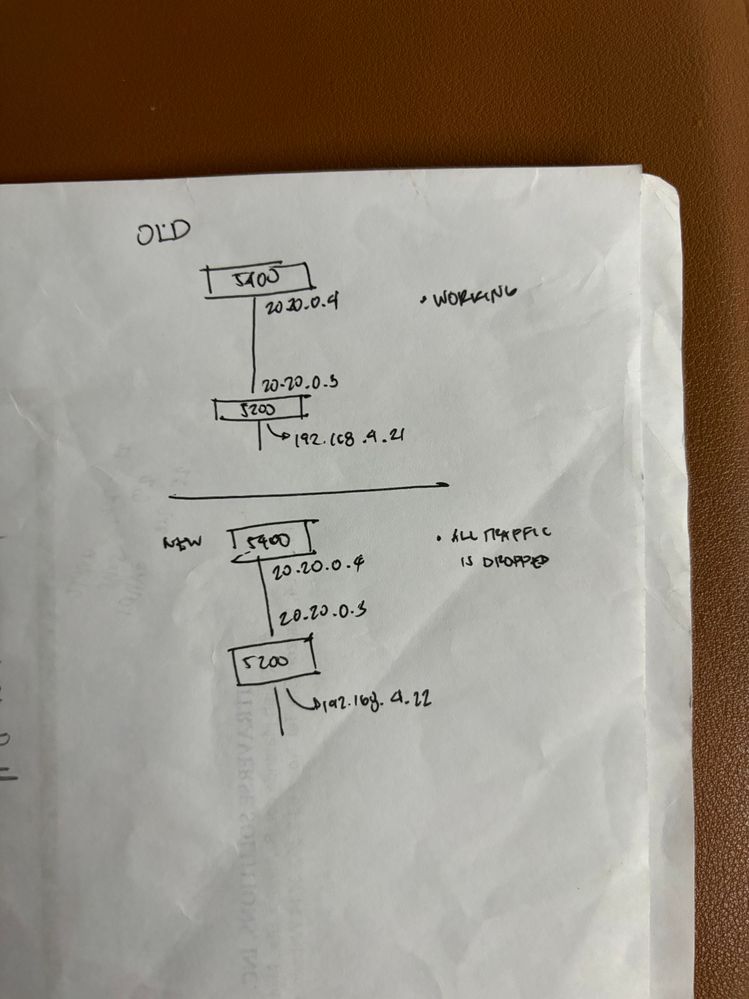

Thats fair. hey, any way you can send basic diagram, just scribble something and point out EXACTLY whats failing.
Best,
SecurityNed
Collaborator
We're really stumped right now. Here's the requested diagram:

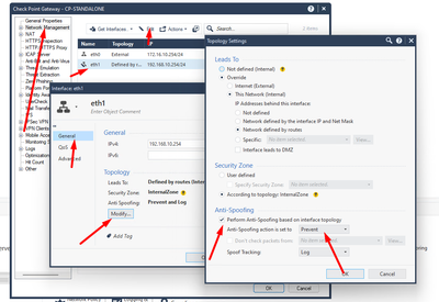

I totally see what @Timothy_Hall is saying.
  • Network defined by routes - The gateway dynamically calculates the topology behind this interface. If the network changes, there is no need to click "Get Interfaces" and install a policy.
Best,
the_rock
MVP Diamond
MVP Diamond
One more thing that just came to my mind...since 20.20.20.x is Azure range, MAKE SURE nothing on that end may had changed.
Best,
Timothy_Hall
MVP Gold
MVP Gold
Do you have "network defined by routes" set on all your internal interfaces for anti-spoofing topology?  If you do and are encountering anti-spoofing issues your routing table on the new gateway is wrong or missing something, full stop.
Also please post a redacted log card of the anti-spoofing drop, and look closely at the "interface" part of the drop log.  Next to the interface name where the anti-spoofing drop occurred, is the arrow pointing down (meaning inbound) or up (meaning outbound)?  While anti-spoofing drops normally occur inbound, it is not commonly known that they can also occur outbound (up arrow) which will stymie your troubleshooting if you aren't aware of it.
For testing purposes you can disable all anti-spoofing enforcement "on the fly" as mentioned in my article below but if your routing is wrong, doing so will not make a difference and things will still not work:
https://community.checkpoint.com/t5/General-Topics/A-Primer-on-Anti-Spoofing/m-p/61580/highlight/tru...
