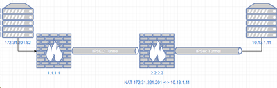

This is the basic layout:
Due to whatever policies, 10.13.1.x can't be connected directly to 1.1.1.1, so the solution was to create the tunnel between devices 1 and 2.
Device 1 is a Fortinet that I have no control over.
The tunnel between device 2 and 10.13.1.x already exists and is ok.
I have assigned 172.31.221.201 to a internal interface on device 2, that is a Check Point device, and created access and nat rules that I can see applied on logs when I telnet one of the allowed ports from 10.13.1.11 to 172.31.201.82
Phase 1 is ok, but the admin of device 1 says it sees device 2 trying to negotiate the 10.13.1.x subnet but not 172.31.221.x on phase 2. Is there any way I can force 2 to negotiate only the wanted subnet?
Should I create a new gateway object for this new tunnel and set the topology to this address? On a palo device I would create a new IKE gateway for each tunnel I want to establish. Is this the same logic on Check Point?
