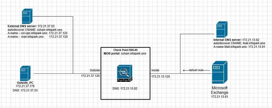

I am trying to publish a Microsoft Exchange server using ReverseProxy Check Point ver. – R80.40.
• Stand scheme:

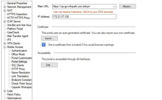

• Mobile Access portal address: https://sslvpn.infopark.uno

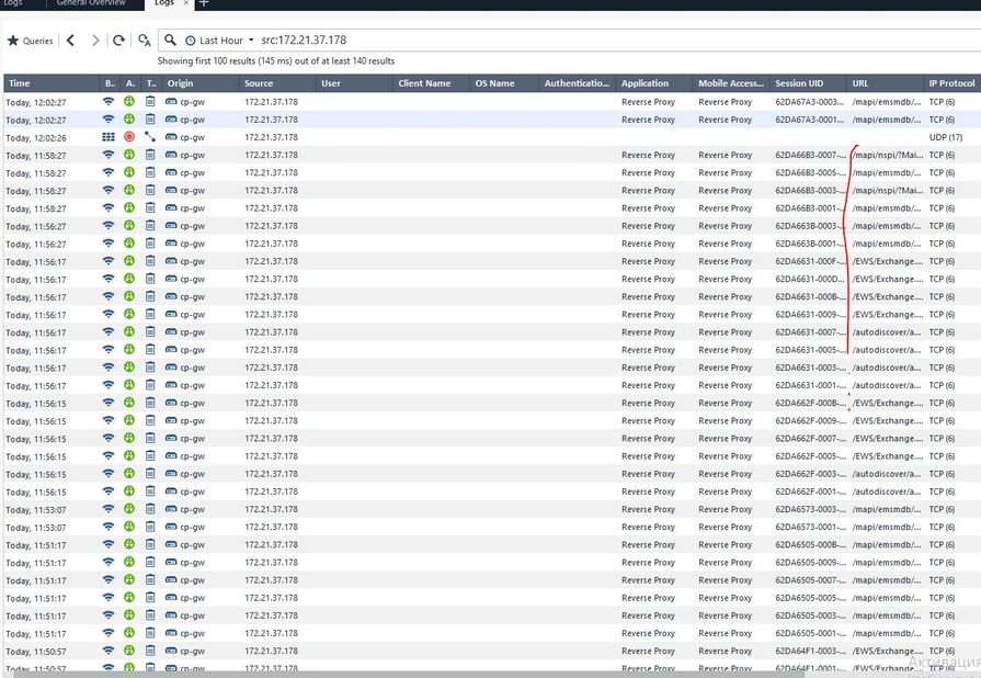

What is the error on the client side? Any logs/errors on Exchange server? Are you using OWA or something else? What HTTPS logs above say?

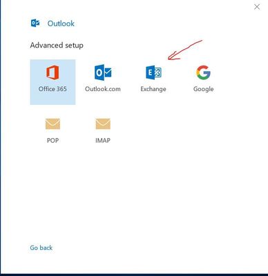

I'am using an "Exchange" connection type.

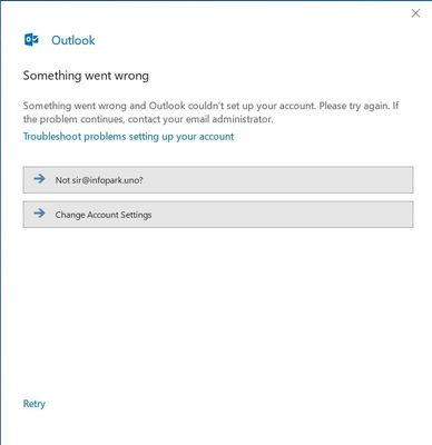

An error after connection attempt:

These are logs at the time of connection from the workstation Outside_PC with Outlook.

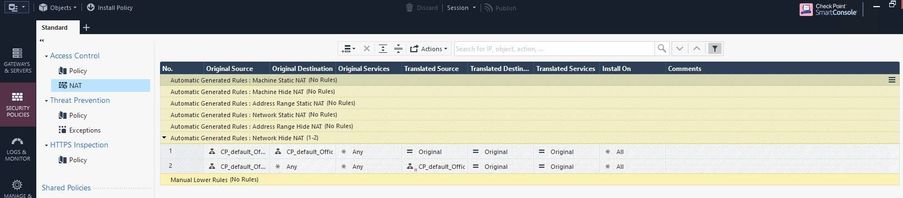

I removed all access rules from firewall and NAT:

I believe your Mobile Access Portal URL on SmartConsole and the External Server Name on the Reverse Proxy rule should not be the same.
You should change the External Server Name on the Reverse Proxy rule to something different than https://sslvpn.infopark.uno (like https://extmail.infopark.uno) that should of course resolve to the same IP (Checkpoint's external IP)

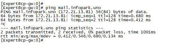

Ping from Check Point gw:
but no positive effect. I still can't see any logs with wireshark on Exchange machine.
Check point GW logs at the time of the request:

reverseproxy logs are visible at the time of connection:
But attempts to connect using Outlook are still unsuccessful.
