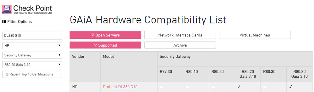

The listing on the HCL definitely suggests it should work. Sounds like time to open a ticket.

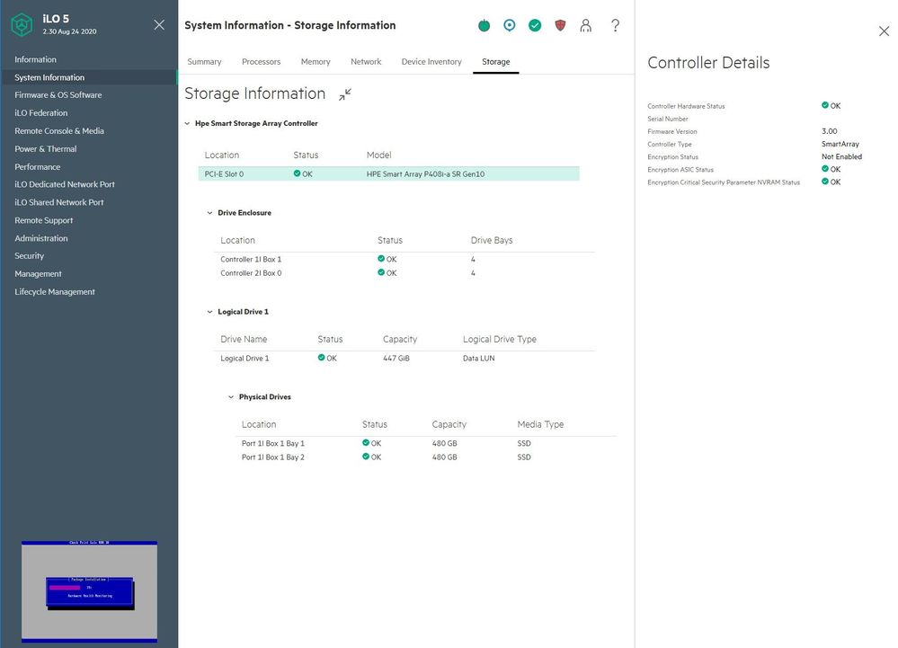

Oh oh, see the difference here:
Firmware version 3.0
G_W_Albrecht
Legend Legend
Legend
Since August 11th, HP strongly recommends for  HPE Smart Array P408i-a SR Gen10 the new bug fixed firmware 3.00, see https://support.hpe.com/hpsc/swd/public/detail?swItemId=MTX_48c00d95ff4d4bc7838dede870#tab4 and https://support.hpe.com/hpesc/public/docDisplay?docId=emr_na-a00097210en_us.
Seems it has not been tested by CP yet...

I am installing on newer HP Servers today and as far as i can see it works on version 3.0 aswell.
Am installing via ILO
