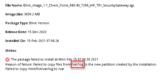

We run R80.30 T155 > R80.40 T91 and it failed:

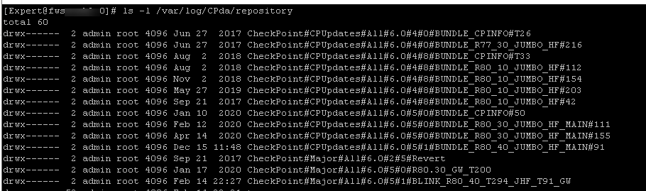

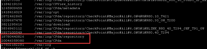

Investigation showed that CPUSE itself was to blame. Download agent repository was consuming over 20GB:
And it had a lot of old stuff, looks like a background cleanup is not very efficient as we have been using CPUSE since R77.30. Lots of R77.30 and R80.10 bundes so I removed all those as well as R80.30 T111
Additionally, /var/log/downloads had some older versions and just consumed space in /var/log, so removed those as well
After that Blink upgrade succeeded with no issues.
