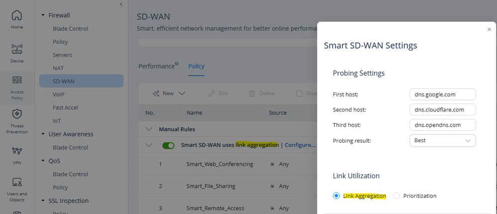

hello, have you find the option for load balancing? or is it a limitation on SMB appliances? Thanks
You are asking in a thread that is over one year old. It is better to open a separate discussion.
