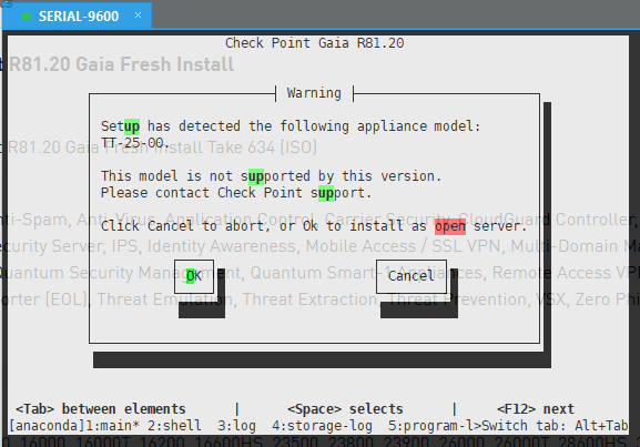

I received a TE250X and some FWs. I looked at the installed software - it was very old (on the sandbox - "This is Check Point's software version R81 - Build 959"). I decided to do a reinstall. I took the current software - “Check Point R81.20 Gaia Fresh Install Take 634 (ISO)” and a fresh “ISOmorphic Tool version 1.1.0 build 207 (sk65205)”.
FW flashed without problems.
With sandbax I had a problem. When selecting “2 - Check Point appliance (any model)”, I get error:
Setup has detected the following appliance model: ¦
¦ TT-25-00. ¦
¦ This model is not supported by this version. ¦
¦ Please contact Check Point support. ¦
¦ Click Cancel to abort, or Ok to install as open server.
I checked that according to sk65205, the “BIOS” profile was selected in ISOmorphic.
Please tell me what I am doing wrong.

Please double check, is it TE250X or TE250XN? I think TT-25 may be the XN model, which only supports R81.
See: https://support.checkpoint.com/results/sk/sk173494
Looks like they are supported with R82 though, according to R82 release notes.

Hello.
Yes, my mistake - I have a TE250XN appliance.

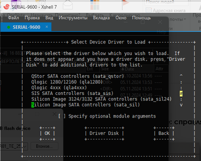

I took a special soft R81 for TE250XN - it doesn't fit, it asks to select a disk for installation:
+-----------------+ No driver found +------------------+
| Unable to find any devices of the type |
| needed for this installation type. |
| Would you like to manually select your |
| driver or use a driver disk? |
| | Select driver | | Use a driver disk | | Back | |
And this selection:
EVSolovyev
Collaborator
Think, may be this helps me. But not (try 5 flash drives). Every time I see:
