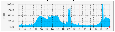

We had some "real life tests" recently on 23800. That was proper UDP volume attack in attempt to fill the internet pipe.
We have 16 SXL cores (HT), running R80.40 T139. normally carrying < 1M pps. Attack pushed it to 18Mpps and FW survived. Of course internet connectivity was a bit patchy due to RX-DRP on interface. SXL cores were pushed to 100% understandably. One before was little milder at 7Mpps and FW feared better than. Graph below shows half of the incoming packet rate
Here's just a sample of one SXL core CPU load:
The feeling I get is that with current 16 SXL core setup we could probably survive 5Mpps  without any problems.
