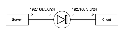

For years, I've been wanting to test Check Point's Custom Application/Site objects' matching logic. Finally got a chance to.
/etc/hosts on the client has these two lines added:
192.168.5.2 gooddomain.local subdomain.gooddomain.local
192.168.5.2 baddomain.local gooddomain.local.baddomain.local subdomain.gooddomain.local.baddomain.local
I built a self-signed certificate on the server and set up httpd(8) to serve a simple page via both HTTP and HTTPS using that self-signed cert. I build a small KSH script on the client with my test cases:

And finally, I set up the policy on the firewall (standalone, R81.10 jumbo 94) in the middle. Here it is in abbreviated form:
