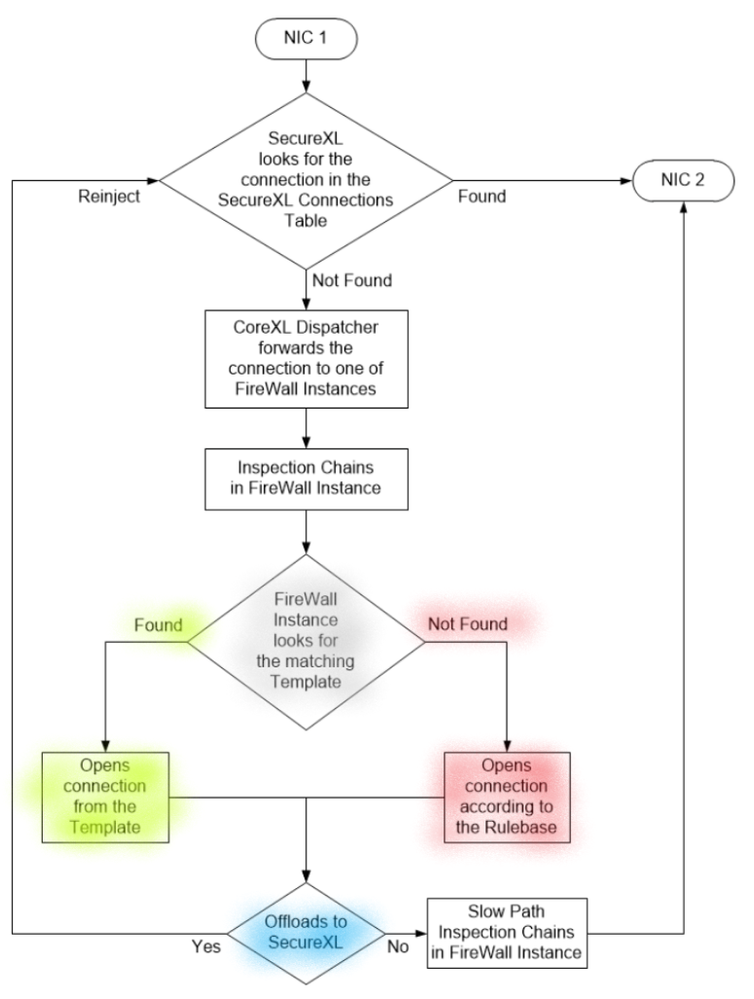

Accept Template in R80.20 and higher:
Feature that accelerates the speed, at which a connection is established by matching a new connection to a set of attributes. When a new connection matches the Accept Template, subsequent connections are established without performing a rule match and therefore are accelerated. Accept Templates are generated from active connections according to policy rules. Currently, Accept Template acceleration is performed only on connections with the same destination port (using wildcards for source ports).
In practice, with R80.20 and higher, I can no longer see big differences in performance whether accept templates match or not. Most packages are added to the SecureXL connection table via SecureXL offloading and reinjection if this is possible for the connection. After that, the SecureXL connection table is the selection factor for the next package.
Packet flow:
CPU cores are divided into two groups: SND (SecureXL) and Firewall instances (CoreXL). Each group handles different tasks.
Tasks distribution:
Task R80.10 R80.20+
Accept templates matching (new connection) & offload to SecureXL SND Firewall
Nat templates matching (new connection) & offload to SecureXL SND Firewall
