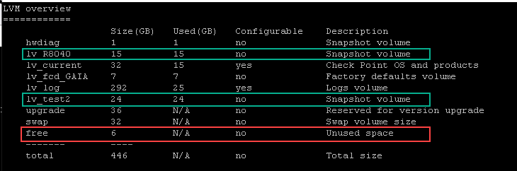

We have no issues as Kris had with VSX itself, but my concern is inability to create more than two snapshots with current "hardcoded" partition sizing, for example in our case 26800T:
I have highlighted in green two snapshots, one taken before R80.40 upgrade (24GB) and another straight after (15GB)
And now we have only 6GB left and that's not enough to add a third snapshot. Whilst log partition is mostly unused 25/292GB!
Whilst I understand that Checkpoint does it's own calculations @sharonab , I would like to show that it seems to be rather "miscalculated" at least for newer enterprise appliances.

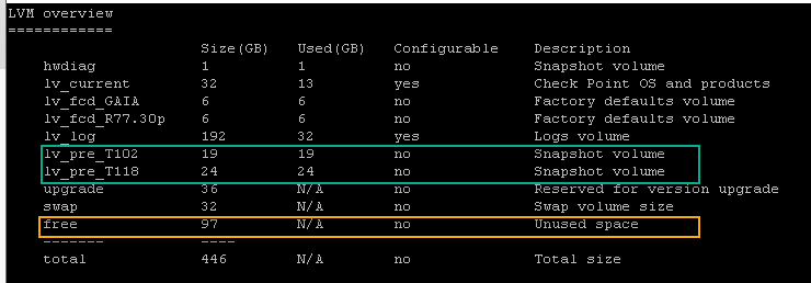

If you compare to 23800 with two snapshots with the same size (24+19), we still have nearly 100GB free as log partition is 100GB smaller:
I think this really needs to be addressed as it is affecting operations ability to perform fast rollbacks if we need to juggle with two snapshots.
@Kaspars_Zibarts i understand your points , and they were raised as part of discussion of future partitioning (and we will keep them in mind).
for your specific distribution 26800T can support up to 128G memory , so in order to support kernel core dump(at max utilization ) we need at least 1.5* memory size (1 for the core it self then as we compress it we need 0.5 of the core size ) which is 192
thanks for clarification! At least I can understand the requirement for log partition! In that case it seems that HDD should have been bigger to support both - core dumps from 128GB RAM and more than two snapshots 🙂
