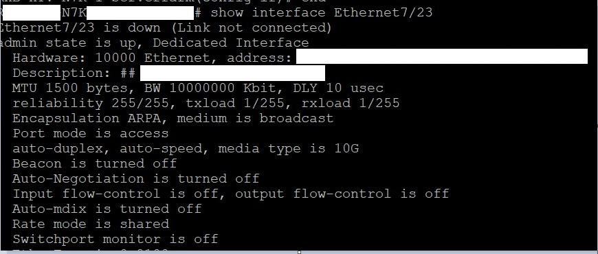

2)Thinking to give a try to force speed to 10G at peer core switch port. Currently is auto speed and auto duplex as per uploaded screenshot. Will it help?
