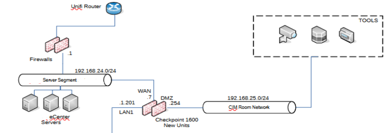

We will focus on 2 segments for this issue, 192.168.24.0/24 & 192.168.25.0/24. 192.168.24.0/24 segment is setup as the WAN interface for the CP1600 and 192.168.25.0/24 is setup as the DMZ interface

We are trying to do a ping and traceroute result from the list of tools from 192.168.25.0/24 to one of the Server in the segment 192.168.24.0/24 where the IP of the Server is 192.168.24.21. All of the tools host have the same network adapter settings where their gateway is pointing to the SMB CP1600.
You will see another Firewall on the left side of the diagram, the Server's gateway for 192.168.24.21 is actually pointing to another Firewall and not the SMB CP1600 but the Server do have a static route pointing back directly to the CP1600 for the segment 192.168.25.0/24 route.

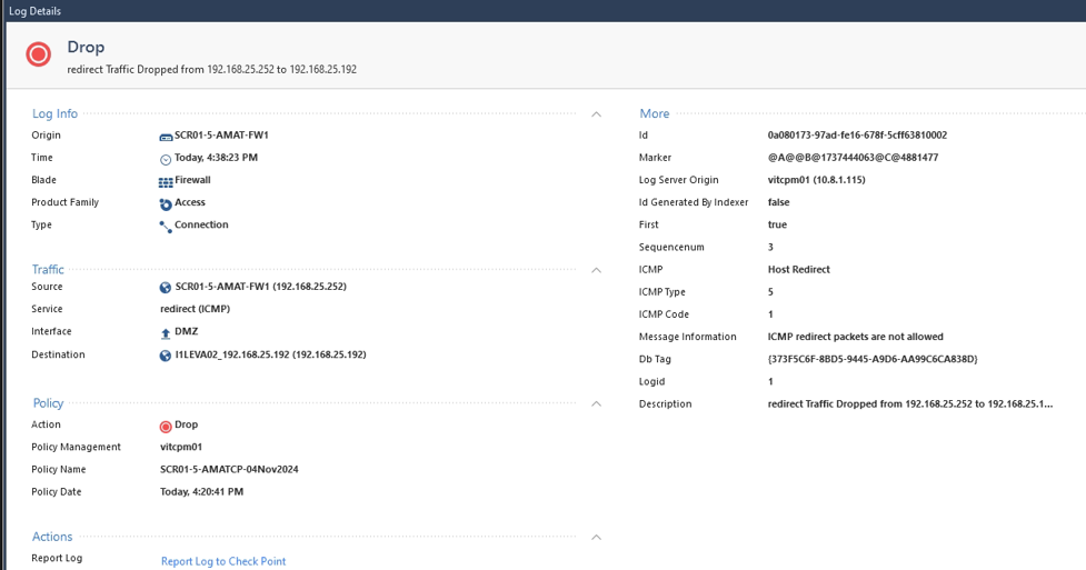

On the Management Firewall logs, we saw for the tools host of .191, .192, .193, .194 all have the same firewall logs of "ICMP Redirect Packets are not allowed" while there are no such logs for the tools host .195 and .210.

I am wondering is this firewall logs of ICMP redirect causing the issue where the tools hosts unable to reach the Server? Why is it only showing for 4 of the tools host while another 2 tools host is working fine?
