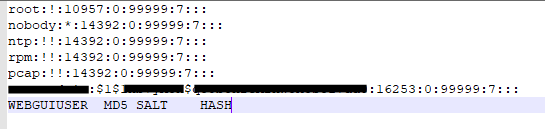

According to sk106025 expert_pass_ file contains the MD5 expert password hash, as expert it can be deleted so the system will ask again for a new password. Also there is the shadow file, that contains MD5 hashed credentials for all users; the web admin among of them (notice the last line was added by me to explain the segments):

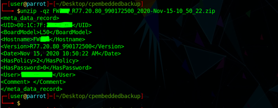

One interesting fact when extracted the ZIP backup on a Windows computer was the following message:

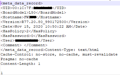

I opened the ZIP file as text to verify, and found the following:
Some metadata is added to the ZIP file, I presume that is to identify the device and proceed with restore. Because of this, I needed to undrestand how backups are generated. I can't only modify the contents under windows since the metadata will be missing after recompression.
After some digging on Internet, I found a 2016 blog entry by John Fleming where he does a great analysis of backup routine using strace. This gave me the necessary flags to recreate the file using any linux distro with ZIP support. So started a live usb image of Parrot linux (you can use whatever you want). The first thing I did was to check the comment for the previously generated backup and found that not all data is added as comment:
At backup creation, this comment is generated by /pfrm2.0/bin/backup_settings.sh execution, adding the relevant info for the appliance:

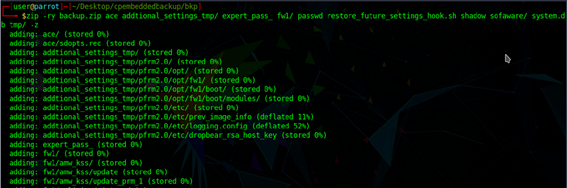

Once all files were extraced, procedeed to edit expert_pass_ file using vim. The unknown expert password hashed data was located here, I replaced it with the information of web gui admin from shadow file (only $1$SALT$HASH is needed):
Zipped a new file named backup.zip using the flags -ry (recursive - include sym links only where is necessary) and -z at the end to add the same comment extracted some steps ago:
The new generated ZIP backup contains almost exactly the same information at the end of the payload. Using echo, I added the final information (maybe this step is not necessary, I didn't test the restore up to this point) EDIT: After downloading a backup through SCP noticed this information doesn't exists; it's only added when the backup is obtained through a web browser. Used -n flag to avoid a line jump at the end, so it matches the original format:

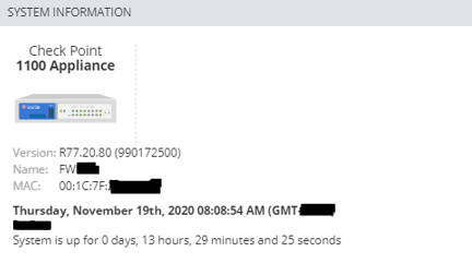

Backup was uploaded and restored to appliance sucessfully:

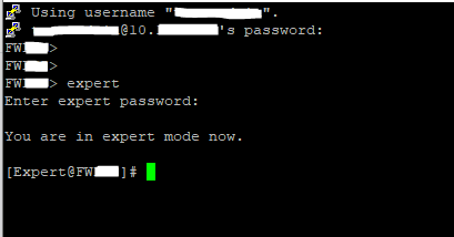

Finally I got expert access with same password as web gui admin user:
