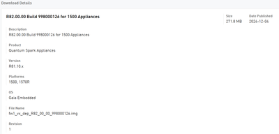

Thanks @PhoneBoy , That's so interesting. then what are these images then?
the are titled R82 for 1500 and 1600 respectively.
found some here but are dated back to late 2024.
1500 Image:  https://support.checkpoint.com/results/download/135816  &
1600 image:  https://support.checkpoint.com/results/download/135913
Sreenshot of image name on the above link:  the are titled R82

Most likely they are old/early EA images for locally managed devices @Amir_Ayalon

Thanks!  @Chris_Atkinson, I found out the hard way by flashing it to a 1535 and it didn't boot. 🙂  but since these Gaia embeded devices revert back to the original image if it fails to boot (after you power cycle it manually), it all returned back to normal.  I do like that feature. 🙂
