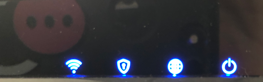

For the older models we have sk123865 LED indicators on Embedded GAIA appliance - but not for the 1550 !
![1550_LEDs.png 1550_LEDs.png](https://community.checkpoint.com/t5/image/serverpage/image-id/3479i38F09C444A32C205/image-size/large?v=v2&px=999)
We have four LEDs, from right to left they are:
- On / Alert LED : Will blink in red for alerts
- Internet LED : Shows if the internet connection is working
- Cloud LED : Shows if the SMB is managed from the cloud, else it is off
- WLAN LED : Shows if SMB WLAN is enabled, else it is off
The first two LEDs were called Power and System on the old UTM-1 Edge, WLAN LED was present as WLAN LED and this model also had a very valuable additional LED - the VPN LED reflecting the current VPN status ! That times are long gone, we now have the Cloud LED that will light up when connected to Cloud management and be off if managed centrally or locally. Initially, i thought this will light up if all TP services are updated to the current version - might be a helpful feature, but this LED only cares for cloud...
