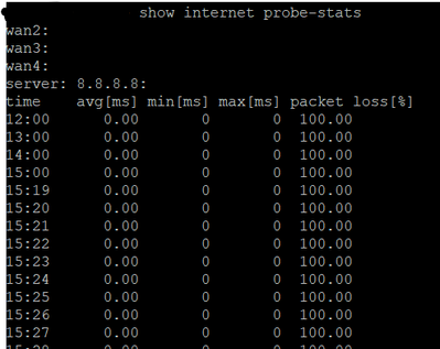

In Spark there isn't the option to set pbr... It seems also the monitoring system really don't work. Is there a way to view low-level log about this? I only got this...

RS_Daniel
Advisor
Hi,
If you want the routes to failover automatically, your next hope must be defined using interface, not IP address. Also you connection monitoring must be configured and working properly on your 3 ISP interfaces.
Connection monitoring is a bit tricky i think. For this monitoring consider: Each ISP should monitor different IP address (dns did not work very well for me), each IP address you monitor should have a static route for that corresponding ISP. For example: ISP-1 monitors 8.8.8.8, you should have a static route for 8.8.8.8 using next hope IP address the default gateway for that ISP, it should not failover in case ISP-1 goes down or the monitoring will flap.
Regards
perfect4situa
Participant
In addition to this I'd like to share an update:
- after latest firmware version (81.10.17) internet monitoring starts working correctly (still some problems with pppoe in cluster deployment)
- with internet monitoring working and static route (pbr) the traffic correctly go trough the right selected and in case of wan failure the route became disabled and the eventually default wan available became the gateway for the pbr network
