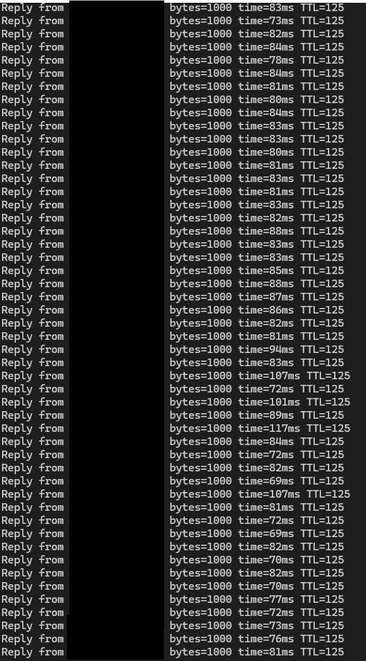

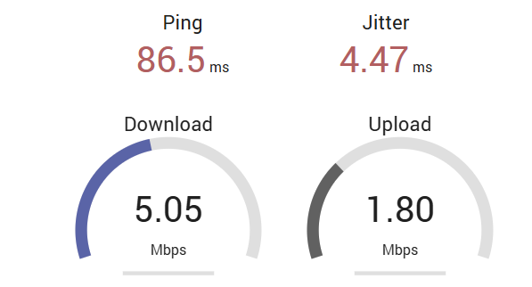

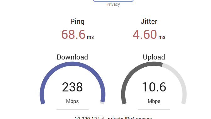

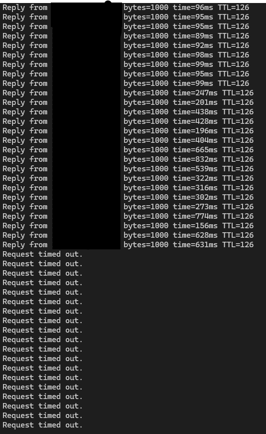

RX-DRP on eth3-01 is still climbing, currently at 17063. Eth3-02 still at 5. Ping test is better.
Packets: Sent = 5232, Received = 5009, Lost = 223 (4% loss),
Approximate round trip times in milli-seconds:
Minimum = 8ms, Maximum = 71ms, Average = 19ms
This seems to vary with load. It's a lot better off business hours. Being Friday afternoon, there are less people connected, roughly 166 where the daily average is 250-270.

Richard_Wieser
Contributor
When speed test starts, the response time jumps up. When the upload portion starts, the pings drop completely even after the test is completed.
On hardware VPN:
