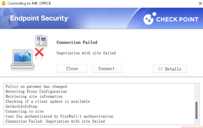

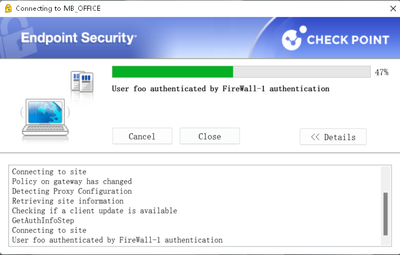

EE88.70 - Connection failed - Netotiation with site failed
Hi, I use a Quantum Spark 1800 Appliance and remote access our company network via Endpoint Security client. I've been using that  for quite a long time but I found that I cannot connect since days ago. It jammed at 47% and then displayed Connection failed - Netotiation with site failed.
my laptop OS is Windows 11 pro 21H2. I uninstalled the old version of the endpoint (it should be a 2023 version) and replaced it with a newer EE88.70. Somehow, the problem still remains.
I also checked my remote access uer account, and reset the password, but it doesn't work.
Any advices will be aprreciated,
Thanks,
Fu

Whoops ... I found probably it's UDP 4500 was forwarded to another server for another VPN client. I deleted this NAT and the endpoint security has been back to normal ....😅
