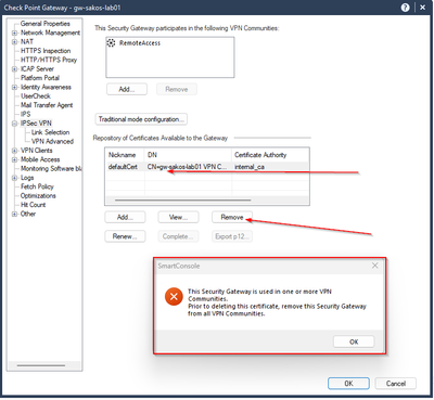

Hi,
My VPN certificate on R81.20 Gateway expires soon and I went through the usual process of deleting the existing and creating a new one, however today I got hit with this message
I have not seen this before and cant find anyway round it. Found a similar post about using GuiDBedit, but that didnt work.
Any help greatly appreciated
Happy New Year

Correct, at the moment I have a cert installed from an EXT CA
When i try to remove (as renew greyed out), the error message appears
I have never seen this before

I had a try, I wanted to delete the cert which was issued by ICA
I got this error:
Maybe helps.

I believe what its telling you to do is remove any references of that certificate currently, install policy and then delete option would work.

yes, I am pretty sure all refences have been removed.
Waiting for TAC
Cheers all !!
- Mark as New
- Bookmark
- Subscribe
- Mute
- Subscribe to RSS Feed
- Permalink
Fixed it.
First took snapshot of SM VM (in case I bust it)
Used GuiDBedit and found entry for VPN refence in the FW object
Deleted it
Saved changes
Said a prayer
Opened Smart Console
VPN reference gone
Pushed policy for good measure
Still gone
Case closed
Thanks for all your help guys !!
