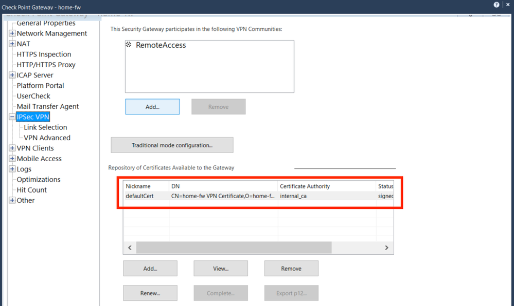

Gateway / SmartCenter
The first step is to export the Check Point VPN Gateway Certificate from the SmartCenter. Also create a local User in SmartDashboard and export the User p12 Certificate.
R80.30 Jumbo Take 191 - Standalone Firewall VPN Object: home-fw |
1) Export the Firewall p12 VPN Certificate (home-fw) from the SmartCenter. To check the Certificate name, open the FW object in SmartDashboard - IPSec VPN - Certificate Nickname (usually defaultCert).
Run in CLI (bash) on the SmartCenter:
Usage: export_p12 -obj <network object> -cert <certobj> -file <filename> -passwd <password>
Mgmt# export_p12 -obj home-fw -cert defaultCert -f home-fw.p12 -passwd 123456
A file named "home-fw.p12" will be generated. Copy this over to the Linux VM.
2)
In the User object create a p12 certificate and copy the file over to the Linux VM. For example: soeren.p12
Make sure that this user is part of the Remote Access community, you can check if the connections works with a Check Point VPN Client using Username / PW for example.

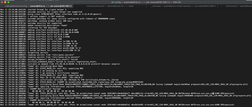

6) Initiate VPN connection to Check Point Gateway
# sudo ipsec auto --add home
# systemctl restart ipsec
# sudo ipsec auto --up home
Connection from Client was successfully initialized.

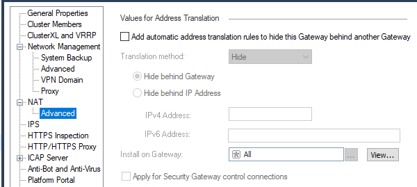

I guess you did not use Office Mode (assigning an "intranet" IP address to the client), right?
I got it working with Office Mode (from the user point of view - SmartViewMonitor still says Office Mode = false) when I set the IP address the Windows client would get assigned by Office Mode in the leftsourceip field in ipsec.conf (in my config, left is the client side). But this is a static config. Getting the client IP from the gateway like the Windows or MacOS client does, would be much better. Assigning DNS servers and DNS search domains is a quite related problem.
Any ideas how to to this (without using PPP (in using L2TP over IPsec))?
Hi Tobi,
this works using IP Pool NAT under the Gateway Object.
SmartDashboard - Gateway Object - NAT - IP Pool NAT - Use IP Pool NAT for VPN Clients only
Let me look into the DNS problem.
Thank you for the quick answer!
I cannot see this option in R80.30 SmartConsole on a R80.30 VPN gateway object (may its because we are using IPsec-VPN blade only and no Mobile Access blade?).
I can see the IP pool option in gateway object -> IPSec VPN -> Office Mode and it is set to Manual (using ip pool). This works fine for the windows and macos clients, they are getting addresses from this range.
You have to enable IP Pool NAT in Global Properties:
Global Properties - NAT Network Address Translation - Enable IP Pool NAT
After you enabled it, you can use it under the Gateway Object.
Thank you, I was missing this master switch for the IP NAT Pool feature.
Using the IP NAT Pool feature is a really good idea to overcome the problem, that libreswan seems to be unable to aquire the Office Mode IP address from the gateway like the proprietary client does.
However, do you know how this interfers with Office Mode for the proprietary client? Can there be a conflict, when using the same network for Office Mode ip assignment and IP NAT Pool for VPN clients? What is happening with static assignments from $FWDIR/conf/ipassignment.conf? I know the last one is preferred over the Office Mode pool, but how will this been put in order with IP NAT Pool?
I would suspect that the IP NAT Pool feature will just NAT all VPN clients traffic, not taking care which IP address they are using inside the tunnel (Office Mode from static assigment, Office Mode from pool or the orginal client IP address when Office Mode is not used (like with libreswan)). As result, this would break the static assignment of static IP addresses to rich clients using ipassignment.conf.
In my setup I use Office Mode and IP Pool NAT for Clients. It works in parallel.

Thank you very much, I did manage to connect, but It I get stuck after connect. Any proposal what could be wrong? See log below
ar 13 20:52:27.509522: "x" #1: initiating Main Mode
Mar 13 20:52:27.527734: "x" #1: STATE_MAIN_I2: sent MI2, expecting MR2
Mar 13 20:52:27.549413: "x" #1: I am sending my cert
Mar 13 20:52:27.549450: "x" #1: I am sending a certificate request
Mar 13 20:52:27.567464: "x" #1: STATE_MAIN_I3: sent MI3, expecting MR3
Mar 13 20:52:27.599959: "x" #1: Peer ID is ID_IPV4_ADDR: '....'
Mar 13 20:52:27.600004: "x" #1: loading root certificate cache
Mar 13 20:52:27.603443: "x" #1: certificate verified OK: CN=xfw VPN Certificate,O=checkpointmgmt.checkpointmgmt.8pkvbf
Mar 13 20:52:27.604121: "x" #1: Authenticated using RSA
Mar 13 20:52:27.604298: "x" #1: STATE_MAIN_I4: ISAKMP SA established {auth=RSA_SIG cipher=AES_CBC_256 integ=HMAC_SHA1 group=MODP1536}
Mar 13 20:52:27.604344: "x" #2: initiating Quick Mode RSASIG+ENCRYPT+TUNNEL+IKEV1_ALLOW+SAREF_TRACK+IKE_FRAG_ALLOW+ESN_NO {using isakmp#1 msgid:efd0b9ac proposal=AES_CBC_128-HMAC_SHA1_96 pfsgroup=no-pfs}
Mar 13 20:52:27.642980: "x" #2: STATE_QUICK_I2: sent QI2, IPsec SA established tunnel mode {ESP/NAT=>0xe9ee1d3e <0xc09a579f xfrm=AES_CBC_128-HMAC_SHA1_96 NATOA=none NATD=.....:4500 DPD=passive}
The client is connected, it is fine. You can also check this in your logs. Probably you need to enable IP Pool NAT too, see description above. Also the client should not be in the same network range like your Encryption Domain.
