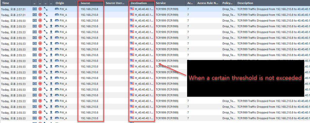

When I enable Drop Template, the smartconsole log looks strange.
Hi
Aggressive traffic frequently occurs in customer firewalls.
So I enabled Drop Template, but logs from smart console are not common
Fields such as src ip and dst ip are not displayed in the log of the smart console.
And 5 logs are combined and displayed.
As a result of my internal testing, when a specific threshold is exceeded for one template, the logs seem to be aggregated and displayed.
Is there a way to output the logs without consolidating them?

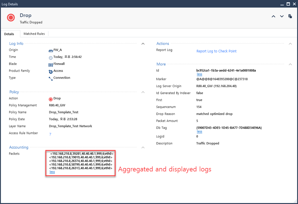

Consolidating logs is good for performance, but can cause problems for troubleshooting in issue situations.
What I'm having trouble with is that because the logs are consolidated, it results in unsearchable logs.
For example, above, I tried to attack with an IP of 40.40.40.1, and the logs were consolidated into one log when a certain threshold was exceeded.
And after log consolidation started, I made an additional attack with the IP of 40.40.40.2, and 40.40.40.2 also remained as a consolidated log, but a single log did not exist, so I could not query it from the smart console.
So I would like to know how to not consolidate logs via DBedit or parameter change

ChoiYunSoo
Contributor
The symptom you posted seems to be different from the one you mentioned.
What you posted is a kind of reporting system of checkpoints.
And just turning off that reporting feature doesn't solve the problem I'm experiencing right now
