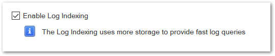

Im on smartconsole R82 Build 1056, but still does not dsiplay the log, even if i go to Logs & Events it does not show up. Instead I have to click log file to see the logs. Did I miss something?
I deploy standalone R82 on virtual machine for lab environment.
@rroihans please open a separate discussion.
In Standalone machine Log Indexing is not enabled by default.
Edit the Standalone object and go to Logs topic to enable Log Indexing
