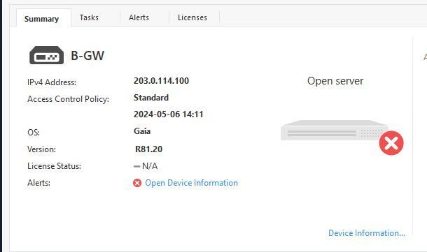

Hi
I got a lab of cluster of 2 gateways. Now I want to add a branch office to the same SMS that manages the cluster.
The branch office has its own external IP for example 203.0.114.100 and main office 203.0.113.1
SMS server is 10.1.1.101 and its gateway is 10.1.1.1
How should NAT rules look like on both sides so that SMS 10.1.1.101 can have communication with the branch office (management traffic I think!)?
What I did is disable NAT inside VPN and add a manual NAT rule to prevent NAT on all networks that uses the VPN:
To be able to add the branch office to Smartconsole I had to add some static routes to my lab router to get connection with branch office
(this router represents the internet, so no static routes are possible, but only external IPs)
directly when I remove these routes I loose connection with branch office (Smartconsole loose connection)
I have created some VTIs between the cluster and the branch office and these can ping each other without the need of the static routes on the router, but still SmartConsole says B-GW lost connection!
Any Ideas!

Connections between gateways and management servers are excluded from VPNs, because the traffic is already encrypted and because you need the connection between gateway and management to be up before you can install the policy that would bring the VPN up. So you need to edit the SMS object and add a static NAT on there (installed on Cluster A) so that the SMS has a public IP that the branch gateway can communicate to.
You can change this, but it's not the best idea because if the VPN goes down and you need to do a policy install on the branch gateway to fix it, you're in trouble because there's no comms to the gateway.
See: https://support.checkpoint.com/results/sk/sk105719
And: https://support.checkpoint.com/results/sk/sk100583

still getting this when trying to install policy on B-GW
tried fw unloadlocal on B-GW but got same result!
emmap
MVP Gold CHKP MVP Gold CHKP
MVP Gold CHKP
It's a network connectivity error, troubleshoot on the network hops along the way.
