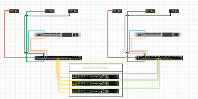

Thank you for reply. I have few more queries regarding the maestro architecture.
Question 1: is maestro always work in Active/Active state in single site dual orchestrator with 3 security gateways connecte with
both the orchestrators and uplink switch is in VPC mode?
Question 2: Can we configure active /standby state in single site dual orchestrator with 3 security gateways connect with
both the orchestrators? if yes , can you please share the design and configuration?
Question 3: if we are using maestro Active/Active mode then how we can configure the interfaces in bond with active and backup state?
as depicted in diagram can we decide which 2 ports always be in active state in bond and backup interfaces will be active in
case of current active interface is down?

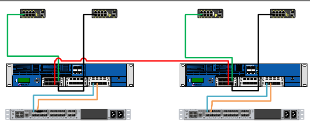

if you have a regular cluster like this
then your deployment should be something like this

Chris in your picture you have the 2 uplinks crossed to the 2 device in the top, we have a situation where the cross was not applied, when the switch in the top left went down, bond/layer2 (during a controlled upgrade procedure) a drop of traffic was encountered for about 20 seconds. Will this cross prevent this drop? My logic would say the MHO was unable to detect that the switch went down. The bond protocol is set to LACP.
So the main question would be: if in the crossed situation 1 link will fail will it also take 20 seconds before the Maestro will indentify the link as down?
