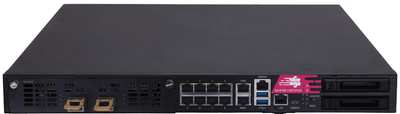

I’m excited to share with you 2 new LightSpeed models, MLS200 & MLS400, and introduce Maestro support previously announced Lightspeed appliances: QLS250 and QLS450.
The new MLS models will utilize Nvidia ConnectX 100G SmartNIC to enable firewall at a line-rate in Maestro hyperscale environment.
The MLS appliances will enable to reach up to 3Tbps of firewall throughput and average of 3μSec port-to-port latency in a 1U form-factor.
In addition, we have now support the previously announced Lightspeed appliances: QLS250 and QLS450 under Maestro
Software release
The new models will support R81.10SP with JHF take 106 release.
Timeline
Catalog should be available for orders starting by this week.
Detailed specifications:
 Model  |
 MLS200  |
 MLS400  |
 GenV Performance  |
 9.5 Gbps  |
 30 Gbps  |
 Firewall performance  |
 200 Gbps  |
 400 Gbps  |
 Expansion slots  |
 1 x 100G SmartNIC  |
 2 x 100G SmartNIC (Built-in)  |
 Memory (RAM)  |
 64GB  |
 192GB  |
 Storage  |
 2 x SSD 480GB  |
 2 x SSD 960GB  |
 Form Factor  |
 1U  |
 1U  |
