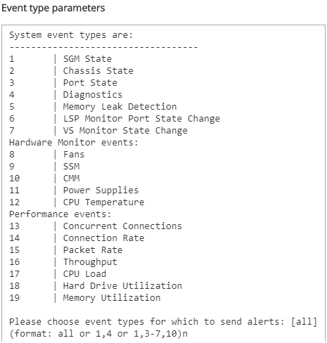

I'm doing a Maestro 140 product with 2 Security Gateway 6800 members.
As I know, to monitor Member, we can use #asg monitor or #show smo verify list to have some command.
I need to monitor the Hardware like (Power supplier, FAN, ...) on MHO and Members but the command asg does not show information about hardware.
Please help me how to monitor and make alert about Hardware on both MHO and Members.

SNMP traps (configurable via asg alert).
SNMP polling (e.g. SGM status).
Refer also: sk168878

Yes but in Security Group don't show Hardware. And on MHO don't have asg cmd

Looks like support for hardware monitoring of Maestro Orchestrators has been added in R81.10 JHFA 93:
PRJ-42979,
MBS-16146
Scalable Platforms
UPDATE: Added support for monitoring hardware of Maestro Orchestrator MHO-175.
