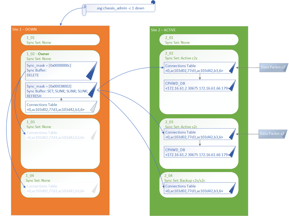

Ste 2 – an Administrator issues “asg chassis_admin -c 1 down” command. Site 1 becomes DOWN and Site 2 becomes ACTIVE.
You can see that the connection entry is deleted based on sync_mask=[ 0x0000000c] which excludes the Connection Owner and includes all the SGMs (included in the sync set) at the DOWN site. At the same time the connection entry is distributed based on the new sync_mask=[0x00038002]. SET, SLINKS and REFRESH are sent from sync buffer via Flush and Ack. DELETE messages don’t use Flush and Ack.

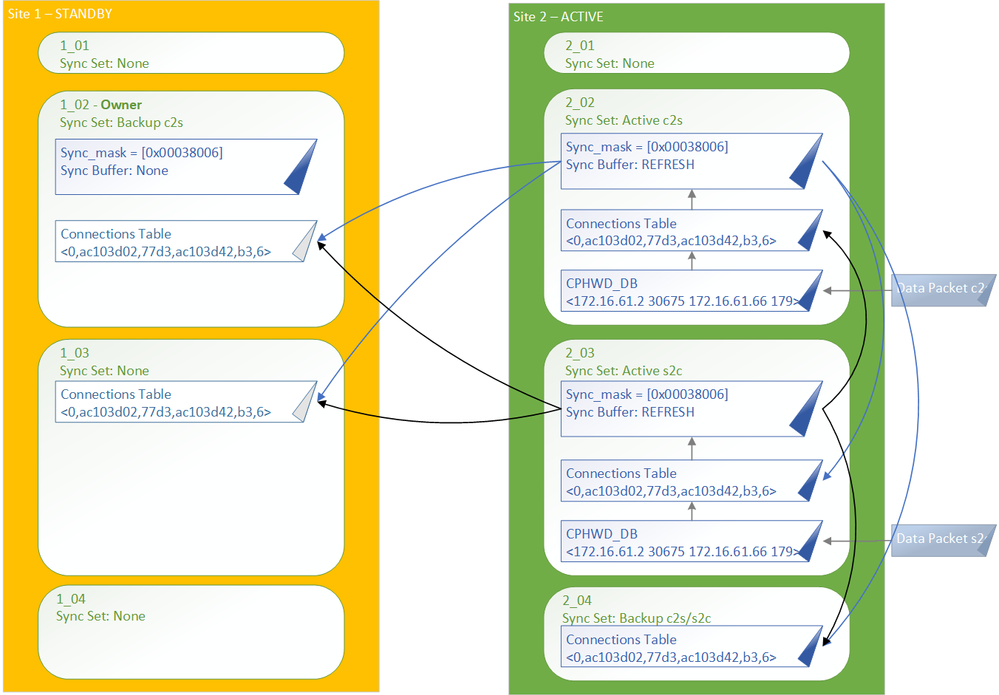

Step 3 - an Administrator issues “asg chassis_admin -c 1 up” commands. Site 1 becomes STANDBY and Site 2 stays ACTIVE.
Two pictures are used to describe the following events.
Step 4 – The switchover is completed. The SGMs 2_02 and 2_03 send REFREESH messages every 512 seconds (default value for cphwd_conn_refresh_interval).
