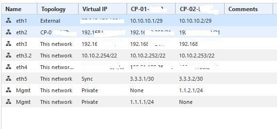

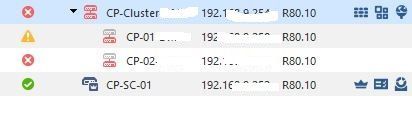

We currently have a Check Point Cluster HA mode.
We made test Vlan in GAIA on both nodes (see pics) and assign virt IP in SmartConsole – after it one Cluster node change state to down. What do we wrong?Network

cphaprob stat
Number Unique Address Assigned Load State
1 (local) 3.3.3.1 0% Down
2 3.3.3.2 100% Active Attention
Local member is in current state since Tue Mar 26 15:10:17 2019

You have assigned an IP address for physical interface eth3. You are trying to add new VLAN on eth3? What is the point here? Such a configuration is not allowed.

The problem was in Cisco port configuration. In our case – ports were configured as NATIVE VLAN mode. After we changed port mode to Hybrid – all works fine.
According sk88700 – no matter have you assigned an IP address for physical interface or not – it works fine if VLAN port on network equipment configured properly .
