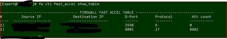

The Fast Acceleration (picture 1 green) feature lets you define trusted connections to allow bypassing deep packet inspection on R80.20 JHF103 and above gateways. This feature significantly improves throughput for these trusted high volume connections and reduces CPU consumption.
The CLI of the gateway can be used to create rules that allow you to bypass the SecureXL PSLXL path to route all connections through the fast path.
Tip 1
Use this function to exclude IP's or networks from deep inspection.
Picture 1
Here you can see the complete packet flow in detail : R80.x - Security Gateway Architecture (Logical Packet Flow)
I will update the document to this new function in the next few days.

I am using R80.40 T118, and am still having problems accelerating some traffic. These rules has been in place for weeks:
The 2nd rule started working after I enabled a global TP exception for the traffic, making all blades inactive for it. I tried the same for the first rule, but it does not seem that anything I do can get the fast_accel feature to work.
BTW, the 1st rule is for internal Citrix traffic over tcp/2598, which is what our NetScalers use to encapsulate Citrix ICA traffic destined for internal Citrix servers.
Hi @Timothy_Hall , thanks for the explanation. I'm not sure I completely understand, though: What is the operational difference between a "null profile" rule with no blades checked and a global exception with all blades checked but specified as "inactive". The global exception gets applied to all TP rules, so would that not prevent the traffic from being inspected by all the blades?
Traffic matching a global exception will still cause it to be inspected in whatever path it would have otherwise, and will usually take at least the Medium Path (PXL) but may end up in CPAS or F2F depending on how TP is configured. Even though there could be a global exception for all blades, the TP policy is checked before any exceptions therefore regular inspection must take place first prior to looking at exceptions and the fast_accel may not work depending on what path the traffic ended up in. All exceptions do is change the final decision rendered after inspection (Prevent, Detect, even Inactive).
On the other hand a TP null profile rule matching the traffic specifies immediately that no inspection whatsoever is required by TP, and when the first packet of the new connection arrives and is accepted, the worker may offload the connection directly into SecureXL for full acceleration if no PXL is needed. The fast_accel just helps encourage that process for PXL path traffic.
