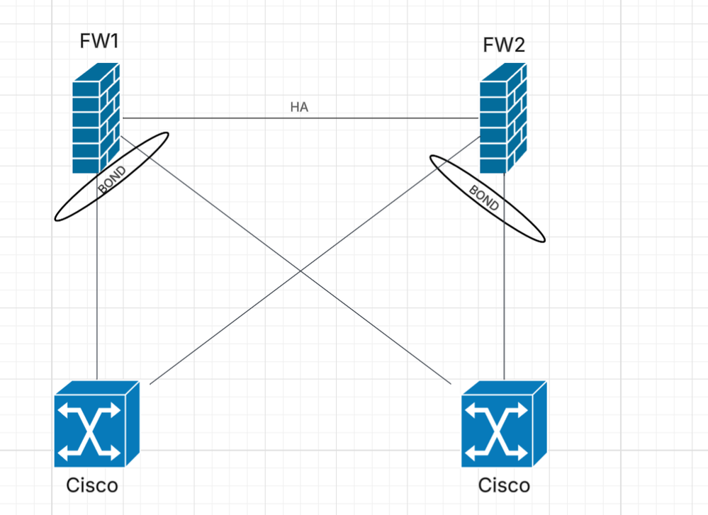

Hi Bob,
Just to clarify my understanding:
In an HA deployment, if one interface within a bond on FW1 goes down, would this trigger a failover, or would the cluster remain active as long as the bond itself is still up?
In my scenario, I’m considering having redundancy across the links (cross + direct connections), effectively treating them as part of the same logical connectivity rather than separate bonds.

By default, the bond only goes down if all of the member interfaces are down. If you want the bond to go down when any member interface is down, set the bond's min-links accordingly.
