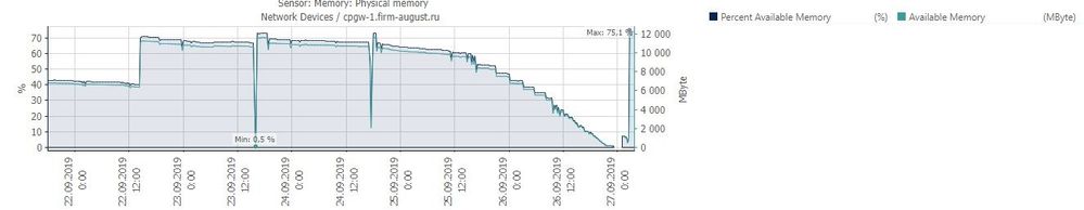

Last sunday (22.09) we upgraded firmware on our Checkpoint 5400 to v.80.30 and this night (26.09) this device has stopped to respond. As we see on our monitoring software the device stopped to respond to Ping at 23:23 (local time), same time it had less than 1% of free physical memory. At 1:00 the device back online by itself with a 7% of free physical memory, and next we manually rebooted it at 2:40 with a 75% of memory free.
So, all pointing to a memory leak on this device after the upgrade, because no any problem with any another device part (like CPU or other).

1. Information from the monitoring system
Have you encountered a similar problem? How did you decide?

Today Oct. 2nd 2019 in the early moring -> FW Kernel - Total 24.012 -> Used MB 24.012 -> Free 0
PRTG monitoring -> see attached file
To time we started a leak_detection on this R80.30 node and watch additionally whit the cli-command
while true; do ps -eo pid,tid,class,rtprio,stat,vsz,rss,comm --sort vsz; sleep 1; done
how much memory is consumed and compare it
